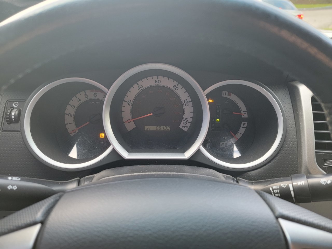

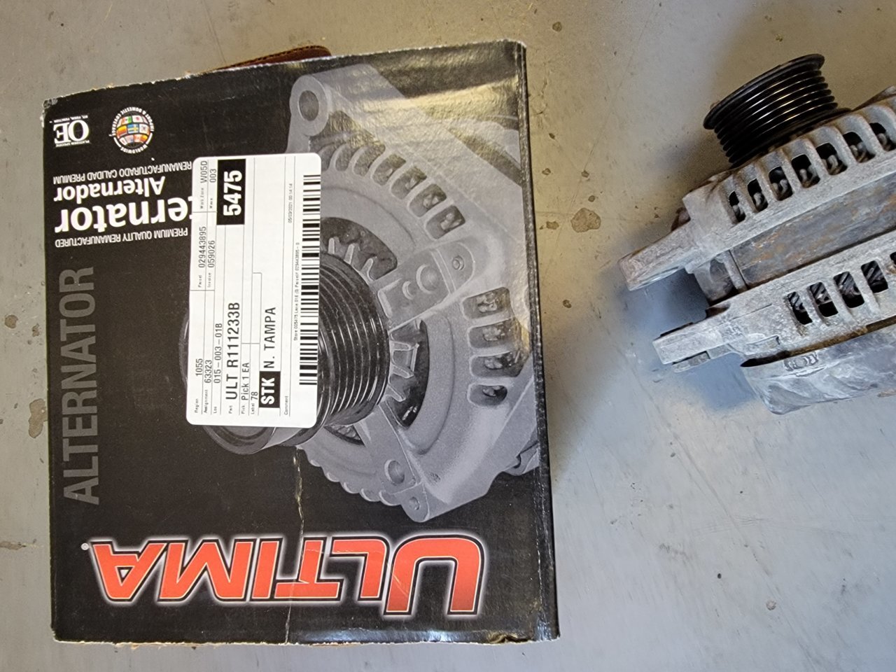

    Last time I posted I didn't post enough info, my bad. The mechanic checked the fuses first and went down the line. He ran the codes and it came back as "replace battery."
    I had the alternator replaced and I also replaced the battery. See pictures below:
    Lastly, I am driving home and the ABS light came back on, idk what to do about that.. Any suggestions?

    Update: Drove it around again, based on the last image I just noticed that the RPM was at zero and temp was "cold" -
    After driving it again just now all gauges seem to be working again and ABS is now off (no lights are on).
