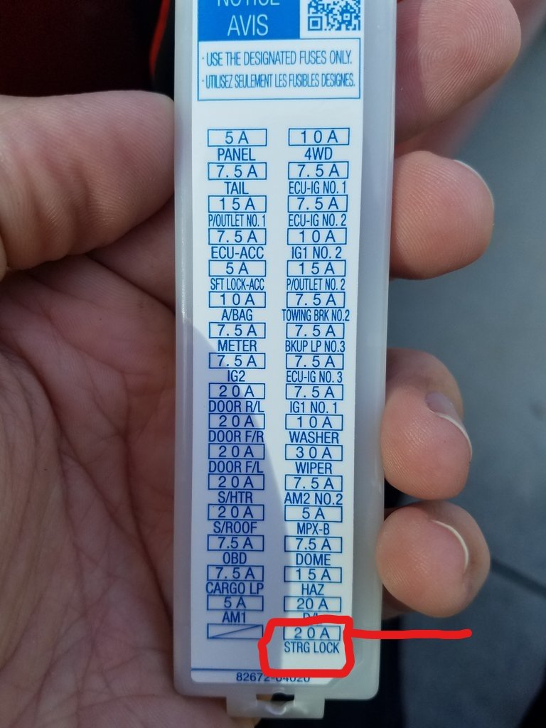

    Markus_War,
    Thanks for jumping in and welcome aboard. Just curious what do you think caused that fuse to blow when you were doing your install.
    fistingfury[OP] likes this.
  4. Feb 6, 2019 at 3:04 AM
    #104
    Markus_War
    Markus_War New Member
    Feb 5, 2019
    #281938
    3
    2017 TRD OR DCSB AT
    Prinsu Rack
    Thank you. My truck alarm went off during install. My alarm went off due to a bad hood sensor that ended up blowing a fuse, obviously you can set your alarm off other ways. My sisters truck after I installed the 12volt kit is still going strong after almost 2 years.

    A defective hood sensor will not blow a fuse. The system gets the hood pin status (if applicable) from information passed along the the CAN bus.
    In OP situation, more than likely the loose wire going to the module was the 12v from the SLP Power or perhaps ignition from the harness. and it shorted with the ground wire or something else.

    You are correct I believe more or less it was the alarm going off then recognizing the fob was in the truck . All good though live and learn. To me with his steering wheel being locked and push button start not doing anything it sounds like the fuse. Not saying it couldn't be wiring in any sort. Only time will tell if OP ever gets back to us.

    Just FYI, peeking at the fuses doesnt do anything. A multimeter isnt really needed the check fuses either. Pull the fuse out and hold it up to the light; you'll know if its blown.
