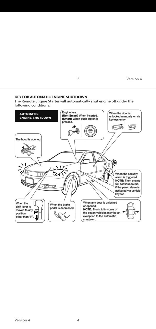

  16. Dec 6, 2021 at 4:07 AM
    #16
    SmileyGuy
    SmileyGuy Well-Known Member
    Nov 21, 2019
    #311305
    499
    Darrin
    Nova Scotia
    20 Tacoma Off Road Voodoo Blue DC SB TRD Premium CAN
    Last 4 remote starts worked properly.
    When coming up to vehicle interior lights come on. Put hand in door handle and truck shuts off. Red alarm light flashed until the start button is pressed.
    First attempt I used spare electronic key.
    Second attempt I used my regular electronic key.
    Third attempt I tried to quickly unlock and open the door.
    Today, no problem.
    There is one state that the vehicle will continue to run, is when the alarm is activated.
