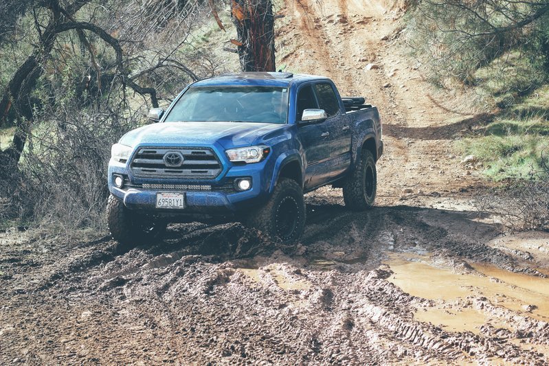

    Couple Pics recently @ Frank Raines OHV

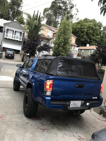

    Got a great deal on a used Bestop from a TW member in Oakland 4/26/27

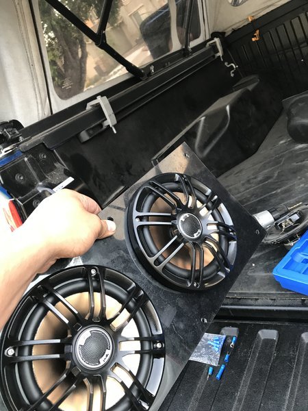

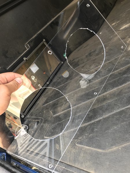

    Bedspeaker cubby mod.

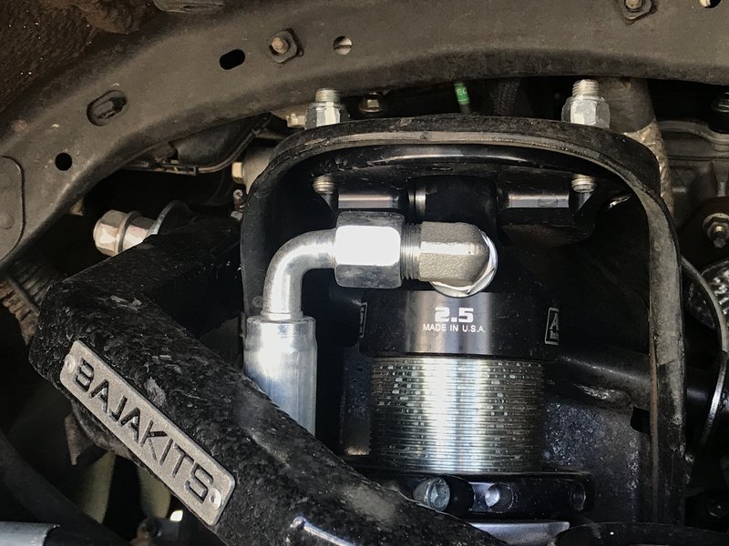

    Guessing those are standard mid-travel fronts since I don't see LCAs. Could you post pics of your preload (if you're going up 3", which I would assume) when she's all done. I'm running ADS switch 650# springs and I'm curious about others. My preload seems a little much but not out of the realm of sanity.
    Driver side attached for reference. Passenger is less due to lean.

    Here is the pic.
    Didnt take a pic of my passenger side because its threaded and at the same lift.
    I do have less clearance on passenger side. I didnt put back the "taco lean" spacer because i will correct that through the coilovers.
    So im leaning a bit to the passenger side right now. The rears are super high due to new leafs and shackle flip.
    Going to give it about two weeks for the springs to settle, then i will readjust from there. Hope this helps, let me know if you want any other pics and i can try to get them and post.

    Looks relatively similar to what I have. You're leaning on the passenger side with similar thread count though? Should be leaning drivers side.
  13. May 6, 2017 at 7:59 PM
    hellaflushca
    hellaflushca [OP] @truck_norriz
    Apr 4, 2014
    #126970
    344
    yes. im lower on the driver side. leaning .. if thats what you meant.
    driver side = low
    passenger = high
  14. May 6, 2017 at 8:11 PM
    kakwvu
    kakwvu Almost Heaven
    Jun 27, 2016
    #190707
    6,768
    Kyle
    WV
    ‘24 JLURX
    Oh, that's taco lean. You just gotta crank an extra rotation or two in and it'll be good. The 600# springs require more preload, but you won't be as stiff as guys running 650/700.
