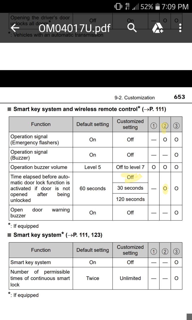

    The consumer can change it through the head unit. Capture+_2019-02-27-19-10-13.jpg
    neegra likes this.

    ^Easiest solution
