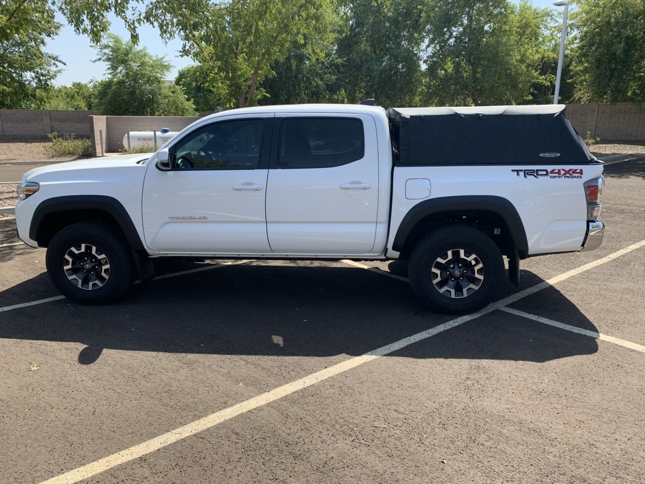

    stock

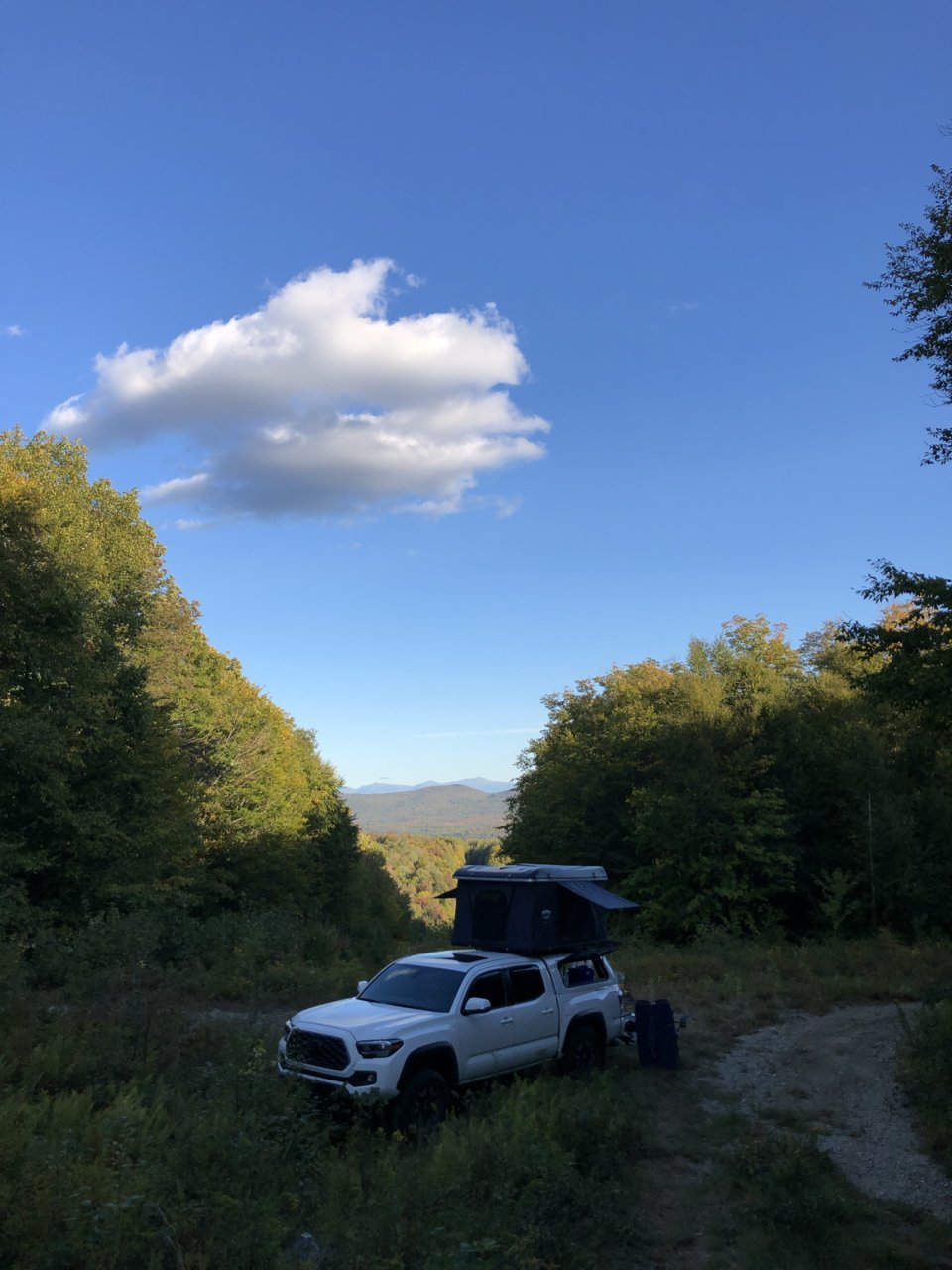

    ARE CX HD that has the internal reinforcement. No problems with my 150lb tent while on bumpy class 4 roads.
