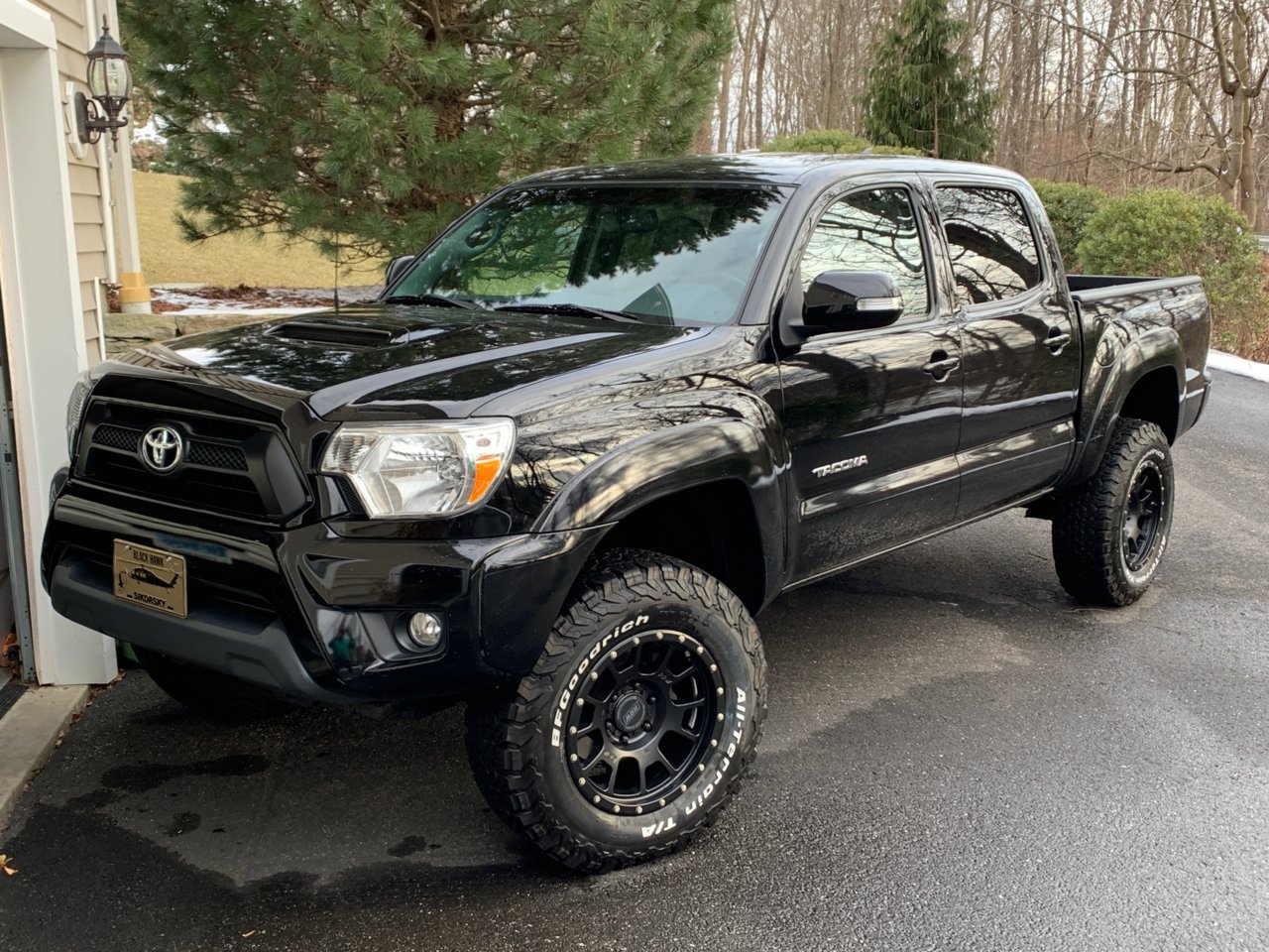

    I just installed my new top plate spacers and new upper strut mounts today, along with a set of SPC UCAs. And I’m happy to report that the spacers have given me about an extra half inch in the front and helped level out my lift. With the new setup up front, I’m sitting right at 3” of lift on the driver’s side and 2.5” of lift on the passenger side. I went back and checked my stock center of the hub to fender measurements and compared to my new measurements.
    Stock:
    FL: 20”
    FR: 20.5”
    RL: 21.75”
    RR: 21.75”
    Current:
    FL: 23”
    FR: 23”
    RL: 23.75”
    RR: 23.75”
    The current setup is Bilstein 5100s all the way around, OME 885 springs on the 0 setting with a 1/2” top plate spacer on the driver’s side and a 1/4” spacer on the passenger side. TSB rear leaf springs with an Icon 3 Leaf Progressive AAL and the overload leaf. I’m going to have my 33” tires mounted and get an alignment early next week and I’ll try to snap a picture of the new stance.

    Current stance with the setup listed above and aligned to 3+ degrees of caster using the SPC UCAs.

    My 2011 Double Cabe sits exactly the same and has almost the exact same suspension setup. The only thing that differs on my end is OME Shocks instead of Bilsteins. I too added top plate spacers from @HeadStrong Off-Road just a couple of weeks ago which leveled out the front. The ride feels no different than it did before I installed the top plate spacers.
