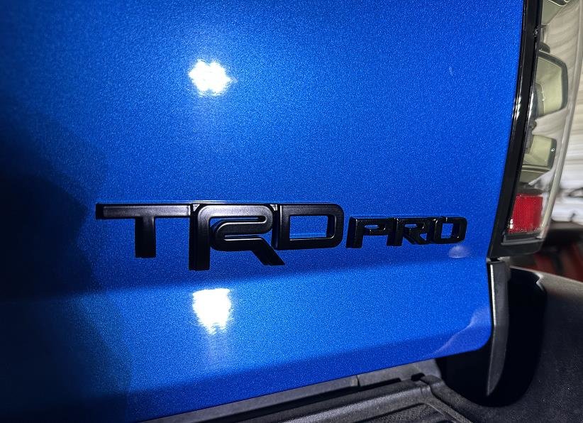

    ok so since I already have the pro grill and floormats, I decided to just lean into it and get the badges too.
    they are solid metal which was nice!

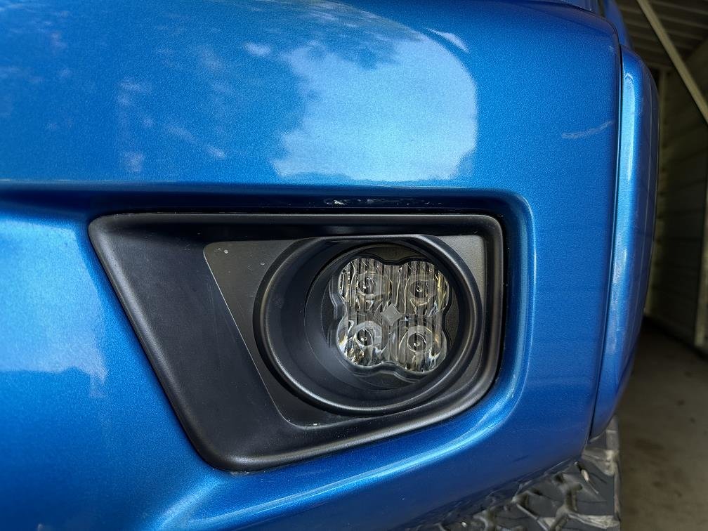

    then I installed some diode dynamics sae led fog lights
    pricy, but they look nice!

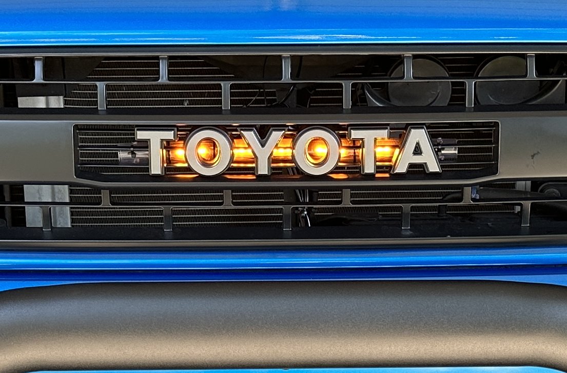

    next, I got a set of those 5 light raptor lights off ebay. now, I dont care for the raptor look, but I did see that I could use them as sort of a low power drl light bar if I zip tied them together and put them behind the toyota grill logo, to backlight it as it were. I ended up using some left over plastic tubing from an aquarium undergravel filter, slicing that up, and shoving the lights into that to keep them straight, then zip tying that down tight so they wouldnt move, then zip tying the ends of that to the grill itself. ive since painted the ends of the tubing black so its not noticeable. I fuse tapped it into the towing slot in the cab. I think it came out rather nice.
    it looks better than the pictures show it, but you get the idea.
    that completes the front end update. most of the changes are around back tho.

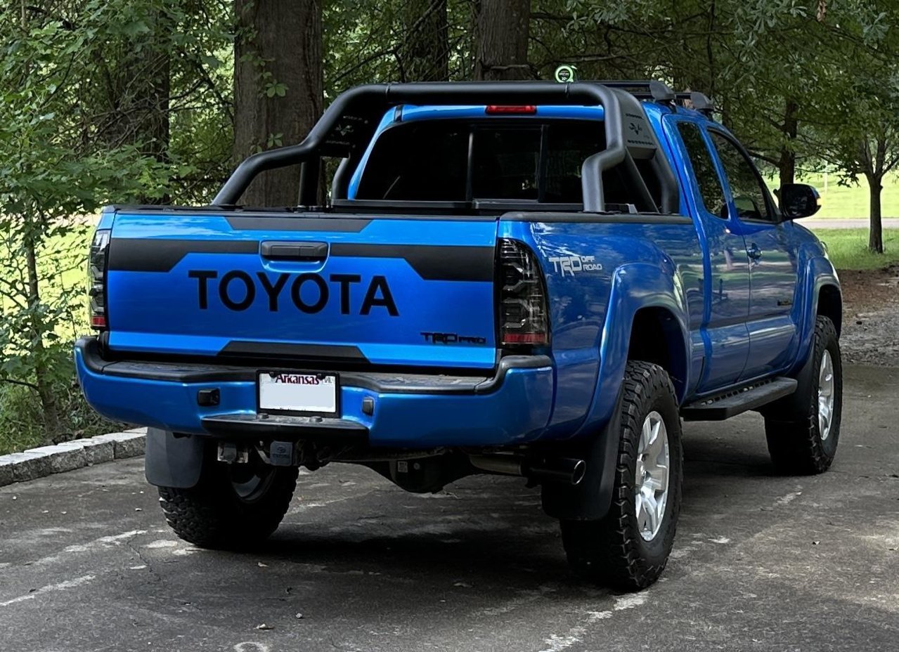

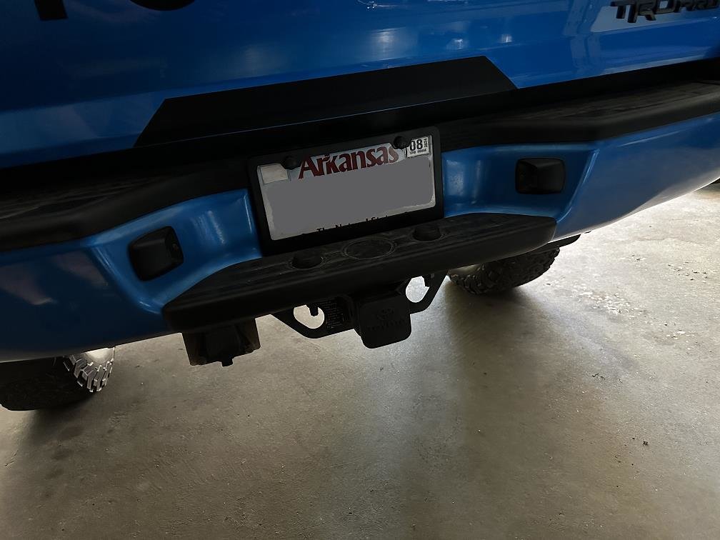

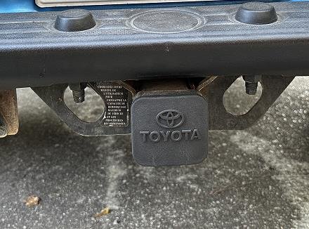

    next I popped in an oem toyota hitch cap, didnt know they made these, no more annoying empty hitch receiver hole.
    also put on a ebay generic license plate frame, it came glossy but some plastiderp took the edge off.
    looks alot better I think.

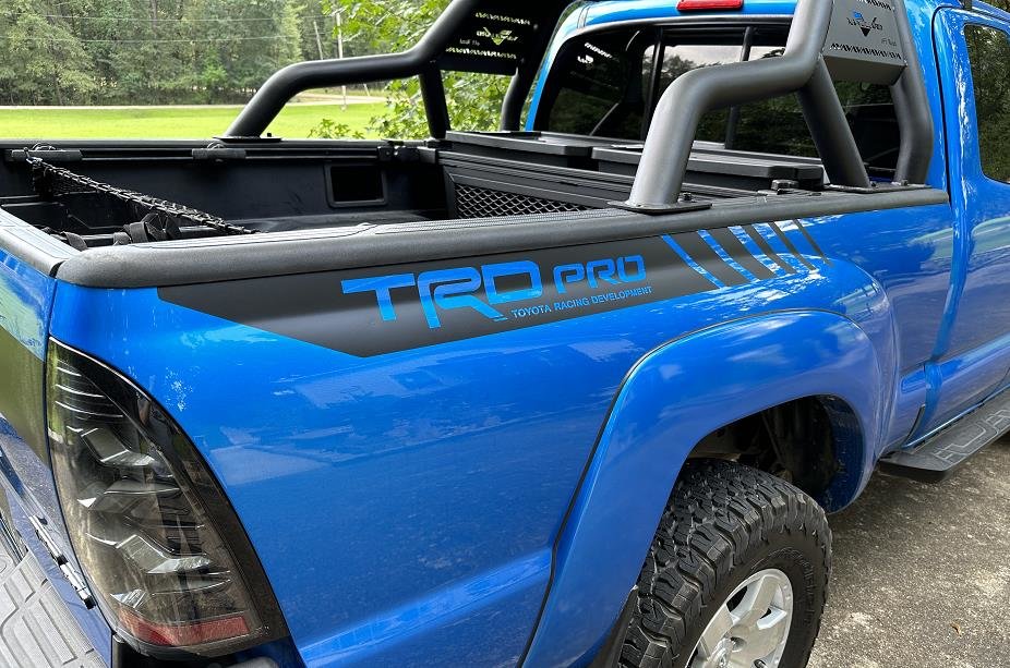

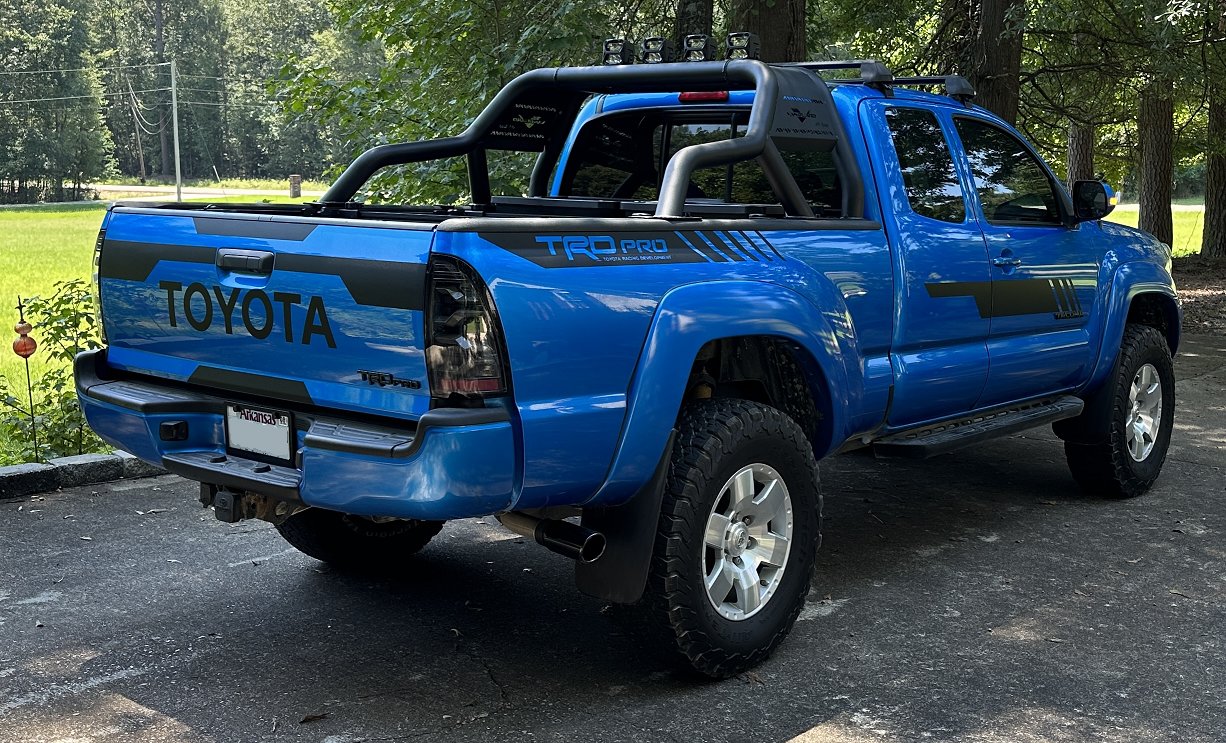

    after that, I installed a vanguard roll bar. ignore the tape measure that was there so I could figure out what size lights I wanted to put in the 4 mounts it has.
    I also put some more black vinyl on the tailgate at the top to cover the last big scratch it has in it.
    a word on the roll bar: I installed this myself, it was difficult but I managed to do it. they want to you drill and use rivnuts to hold it down, I suggest you throw those away, because as it turns out, like most everything on our trucks, the plastic bed caps arent part of the composite bed and will pop off if you pull up on the ends. I first set it where I wanted it, marked the holes, then took it down and popped off the bed caps and went to home depot and got my own hardware and drilled the 6 holes and secured them on there, and then with the bed caps attached to the roll bar, I then set it back on the bed, a tricky operation but I managed it. now, I thought that having the only method of securing the roll bar to the truck relying on the plastic clips in the bed caps was pushing it, so I got some bedrail nuts from (I forget where ill edit it in later mabye) and tied off the front to 4 of those, then I got some angle brackets for house framing and drilled holes in those so I could use the convenient bedrail bolts that came with the oem bed divider, and I also got a second divider, so 4 of those hold the bed caps down tied into the rails and I think thats about as sturdy as I can make it. it didnt wiggle around before, I just wanted to overdo it.
    I chose this specific roll bar because I liked the looks mostly, and it was tall enough to not block the 3rd brake light.

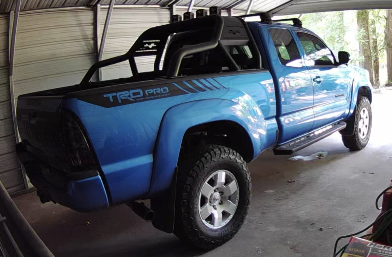

    next up I removed the old grey off road bedside decals and put on this pro one, because since I already had the pro grill, mats and badges I may as well full send it and get these too.
    I pushed them up a bit to mesh with the black bed caps, and also to hide some more paint nicks and scratches. has that old school graphic fade I was looking for. going to put some more of that on the door sides I think, then we are done with the graphics.
    then it was time for the roll bar lights!
    I found these novitech ones on Amazon, they looked unique, werent too over the top, and most importantly were inexpensive. mabye someday ill get the full morimoto big bangars but not today, bit too pricy, and these are 12x cheaper than those. ive only bolted them on tho, ill figure out the wiring later this year when it starts to cool off, too hot to fiddle with that now.
    one more pic for today

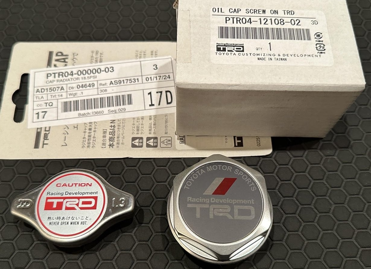

    installed trd oil cap and rad cap. old ones needed a refresh and decided to get something nice. part numbers included if you want one.
