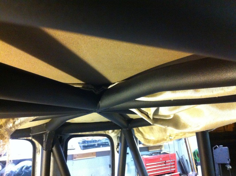

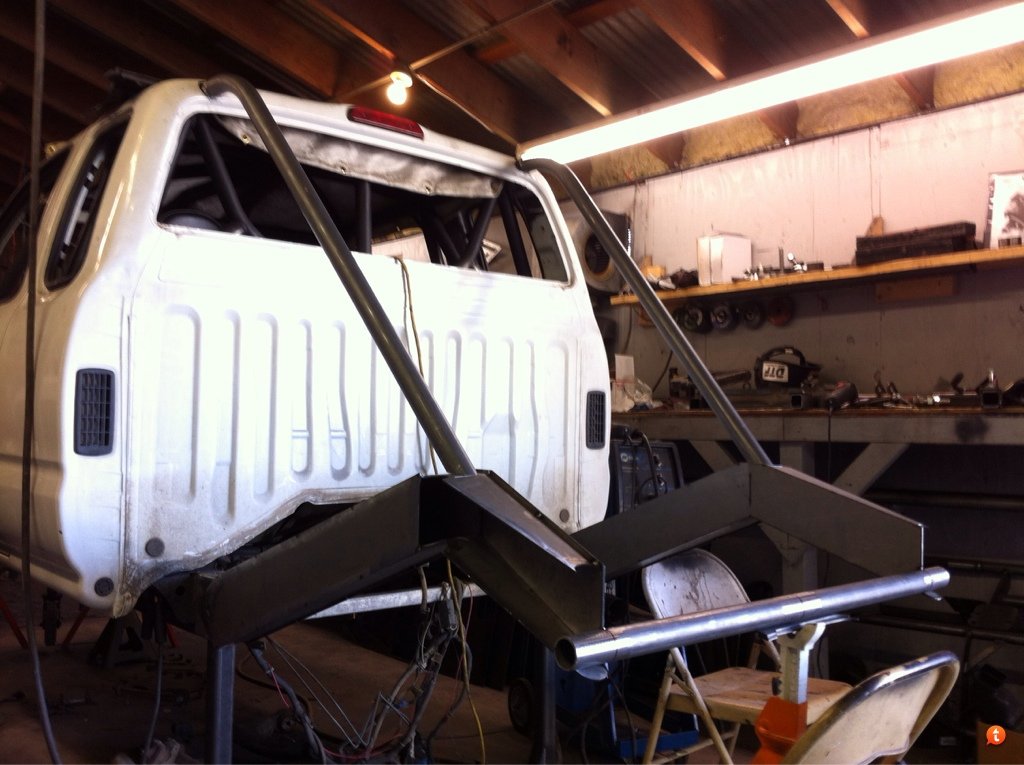

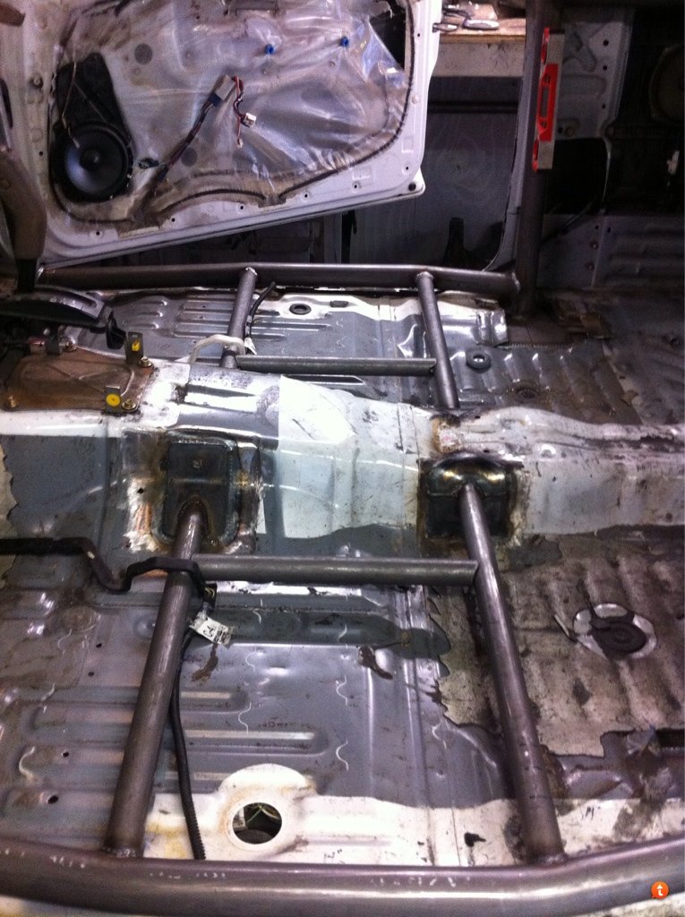

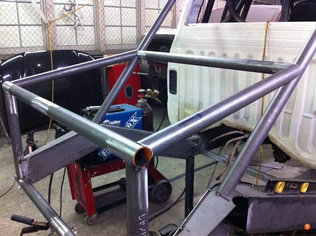

    Got the cab on solid mounts
    before I put the cage in place
    Slipped the welding blanket in so I can finish the welds in the cab.

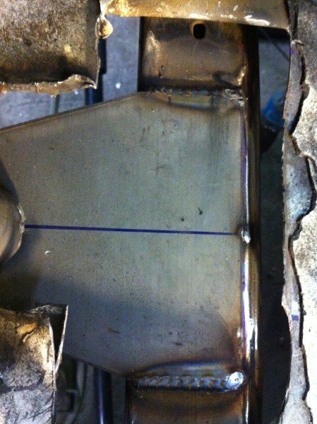

    Cage tie in's started. It will tie into the lower link pocket

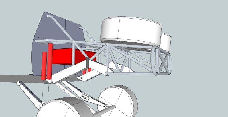

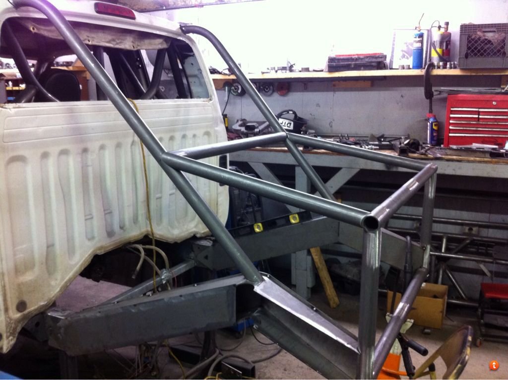

    Also got the new back half designed
  5. Mar 21, 2014 at 10:30 PM

    Looks sick man! Whens the backhalfing happening?

    Soon just making sure I get everything how I like :cool:

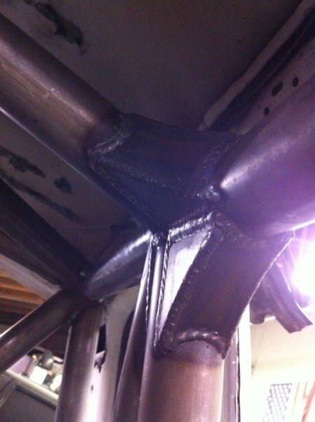

    I like how you put the headliner back in. I haven't seen anyone slip that in after dropping the cage so I figured it was impossible :notsure: I'm going to try and do that on mine.
    And the corner gussets are clean, so much nicer than a tube!

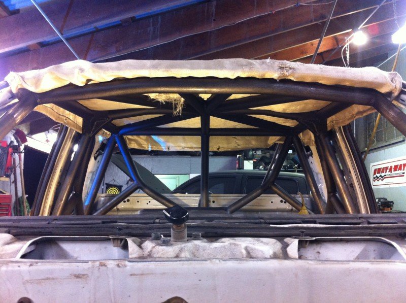

    Been a little while since I've looked at your build. Good shit! :popcorn: Did you sleeve the tubing at the top of the C pillar hoop?

    Thanks!
    And yes
