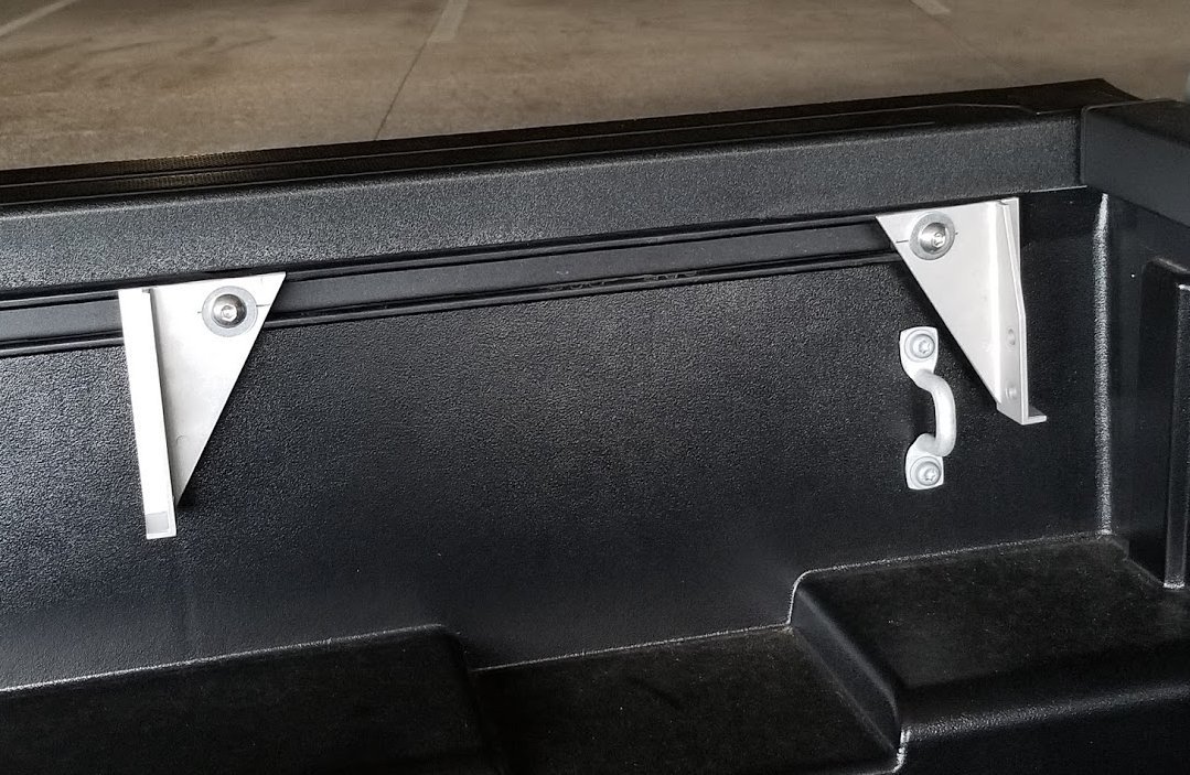

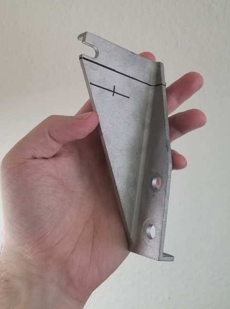

    Bracket that comes with the kit. I marked the line for the cut (there are some overhangs on the other side of the top part) and the point for the hole. The hole would be better at least 1/2" lower (maybe more) so that the box is higher and it's not that snug against the wheel well.

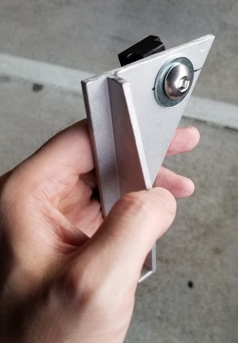

    Cut, drilled with the t-nut and bolt.
    In the rail.

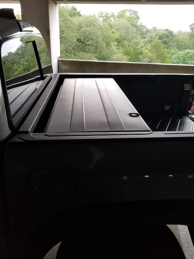

    The box mounted.
    From the side. It sits an inch or so below the side of the bed. It could be raised this much by drilling the hole in the bracket lower. I don't know how tonneaus are mounted but I'm guessing this wouldn't be compatible with them anyway.

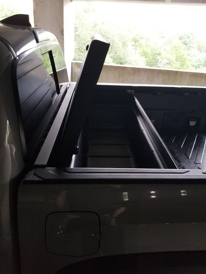

    Open.
    Space under it. As you can see it kinda sits on the wheel well which is not to my liking but it's ok for now. I might make entirely new mounting brackets if I have time.
