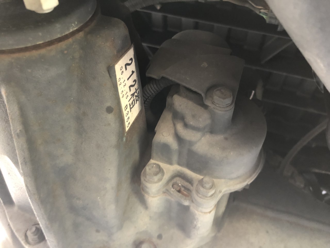

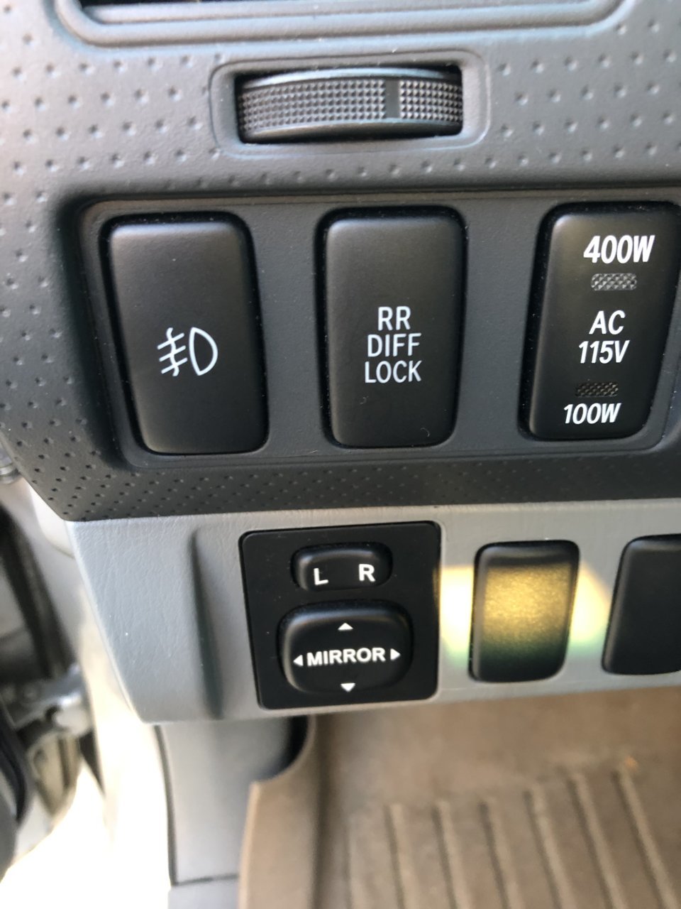

    I don’t have A-TRAC.
    I have the Locker, and Locker only.
    No Stability control.
    ABS is all I got.
    Here is my locker
    B007A2DC-12E3-4F11-B232-8F427B372D22.jpg 5C4938A6-43FD-49BC-94C3-F1209C1738F9.jpg
