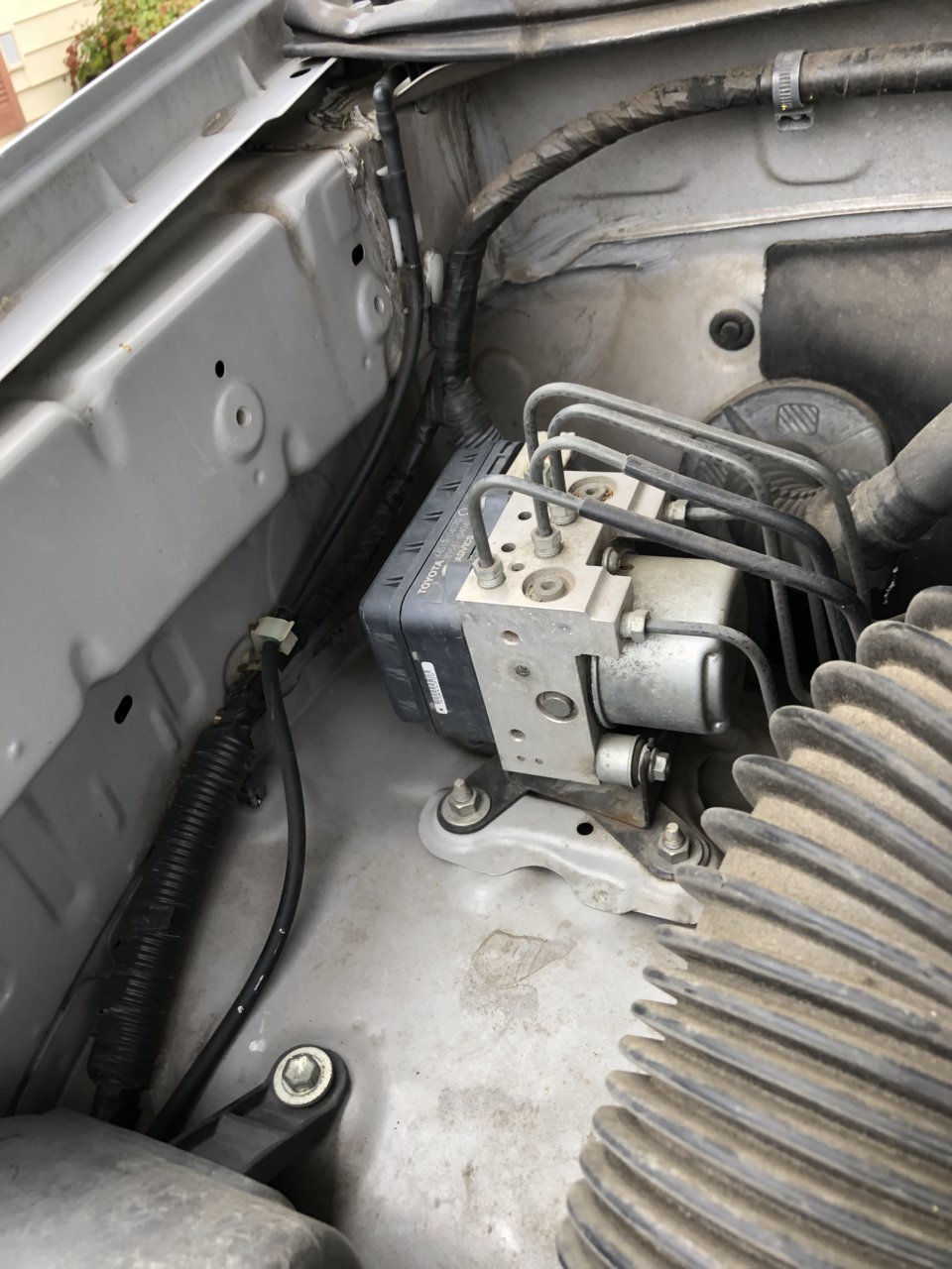

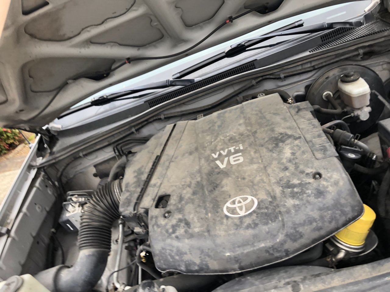

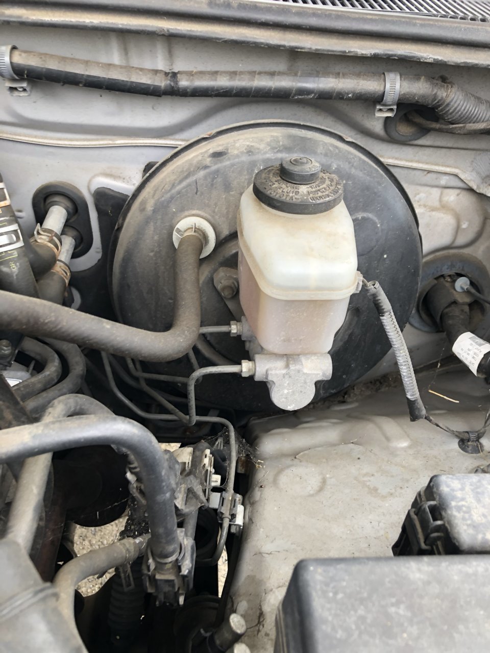

    For future reference, here is the “old style” brake/ MC.
    The MC and ABS module live on different sides of the engine.
    The positive side is it’s cheaper than the newer style. Negative side is, is not near as powerful as the new er style.
    Yeah. The engine is dirty. It doesn’t bother me.
    D31E44B5-36D1-45CA-A930-7F3604CF6518.jpg 9EE4E38A-61BA-4A67-A1D7-DDFDCEE126BA.jpg 98F364CA-A73E-4193-9316-F6449507F059.jpg

    So that's what that set of brackets is on the passenger fender well on my 2014 TRD OR. Good to know. I've considered mounting an ammo can or something there, just never really had a need for it. I keep a tool bag on the floor behind my driver's seat.
