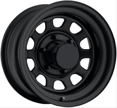

    I called summit to place my order and they cant seem to tell me if they will fit. They have numerous steel wheels on there site. so im looking at 16x8 with a bolt pattern of 6x5.5, here are my options
    4.25 backspace and a -6 offset
    or 4 backspace with a -12 offset
    i dont care if they stick out a bit, i actually kind of like that. I just want to make sure they clear the calipers.
    2003 4 door tacoma trd 2wheel drive
    Thanks yall

    Never seen them on a 1st gen so I'm guessing they don't fit.

    Pretty sure you need at least 4.5 back spacing to clear the calipers. You could always just install a wheel spacer on the front to clear them

    Your gunna need some wheel spacers to make these fit

    Or else it's gunna rub on the caliper

    Thanks bro. I ordered the 52 series...suppose to fit perfect...i hope...lol

    Did your wheels fit? I was thinking about getting them for my FJ. I'm running 1.25" spider trax though.

    sorry, i meant 87 series. not 52. i mount them tomorrow
