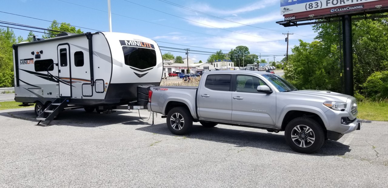

    Hi everyone, I'm new to this forum, but not new to owning a Tacoma. Excited to find this forum after having owned a TT for almost 20 years. I'm looking to purchase a 2021 Rockwood Mini Lite 2104S, (see pic) however I'm concerned about the ability of the TT to safely tow it. Will need to retro fit a towing package to include hitch, 7 pin electric brake controller, tow receiver and Trailer Sway Control. Dry weight is 4841 lbs. and GVWR is 6774 (I don't plan to tow with it full of water).
    I'm finding contradicting info re: how much to tow. Has anyone been able to tow something of this size safely and if so, beyond the towing package and what I've mentioned, what else did you have to do?
    Thanks so much!
    DJ

    That's right at the top of the towing limit on the Tacoma, it'll do it, but it will be white knuckle driving. Along with the 8 mpg you'll likely get towing on the Hi Way, there's no auxiliary oil cooler on the Tacoma anymore.

    Its gonna be borderline at best. 4800lb trailer, plus a weight dist hitch, plus your camping gear and people is going to put you at or over the gvwr of the taco.
    The other factor here is the frontal area of the trailer, you're basically pulling a sail. You'll need to go slowish to keep any sort of good gas milage (no more than 65)

    Brake Controller, weight distribution hitch and mirror extensions. And drive slower. And they aren't kidding about 8mpg, so be prepared for that.

    DJ, the tongue weight on that 2104S is listed at 614# dry. Too much for for the TT with WDH. (Hope you haven’t bought it yet).

    For a Tacoma, I'd seriously be looking at a 7 foot wide trailer, not 8. Visibility would be much better, and you'd be cutting down a lot of the wind resistance. Have you checked out the No Boundaries NB19.6? 7.5ft wide, little bit longer, but similar layout, 550lbs lighter UVW. Larger murphy bed actually. 124lb lighter hitch weight, too (490). @wiljayhi , i see hitch weight on the Forest River page as 614, but obviously with distribution hitch it would be over your 640 anyhow...

    Dont buy the trailer.
    If you do, plan on buying a full size truck.

    Smaller trailer or much bigger truck

    Thanks to all of you! I can't tell you how much I appreciate the quick, informative responses! Based on what I had already researched, your feedback was a validation that moving forward was not the right thing to do. I haven't purchased the trailer and again, based on your feedback, I just called the salesman to tell him the sale is off. Thank you again! DJ

    OP you don’t even have a tow package. Your max tow weight is around 3500 lbs. No matter what you do or add to the truck it won’t change the manufacturers tow rating. Only the manufacturer can assign the weight ratings and they don’t change the rating once it leaves the factory. If you are going to tow over about 3500 lbs you need a different truck.

    You can add whatever you want to the truck but it doesn’t change the legal official manufacturers max tow capacity. It won’t change the number that is in the owners manual and on the door jamb. The problem arises when you are towing above manufacturer tow rating and you have an accident. In this case the OP would be about 2000 lbs over the tow capacity. His liability would be huge and he could get his ass sued off. Major injuries or death he could be sued for amounts beyond his insurance liability limits.

    I wouldn't tow it with a Tacoma. Forget the tow rating, it is payload that will bite you in the butt. Assuming you're at 5500 lbs ready to tow you'll have over 800 lbs on your tongue with the required weight distribution hitch. Figure 13% of trailer weight plus about 100 lbs for a WDH.
    You'll just have to check the payload rating of your truck they are all different. But a typical 4X4 Double Cab is going to be 1000-1200 lbs. With 800 lbs on the hitch that only leaves 100-300 lbs for the driver, passengers and any other cargo in the truck. That just isn't realistic.

    Not to mention that the hitch only supports a max of 640 or 650#s with the tow package.
