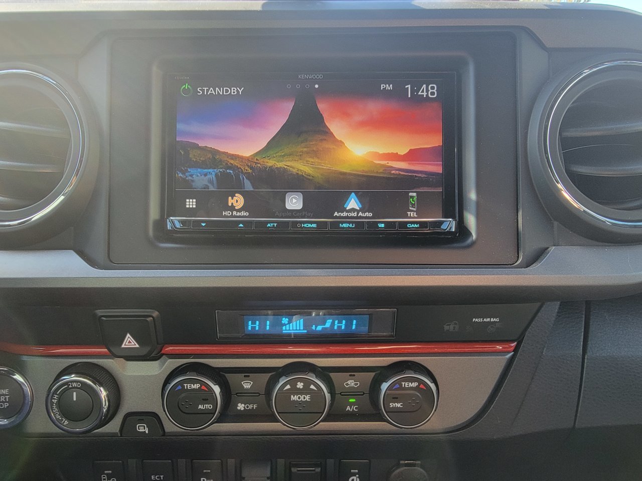

    I scored a pretty sweet Kenwood for the 800 you're looking to stay in. Carplay, all the features and great picture.

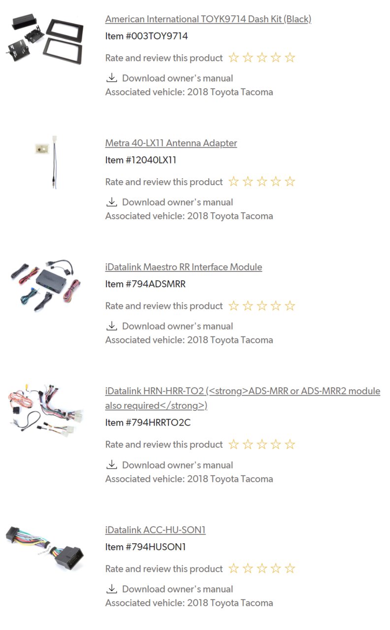

    So, the gotchas that Crutchfield didn't pick up on.
    When I built out the combo for my truck on their site, they recommended the following parts:

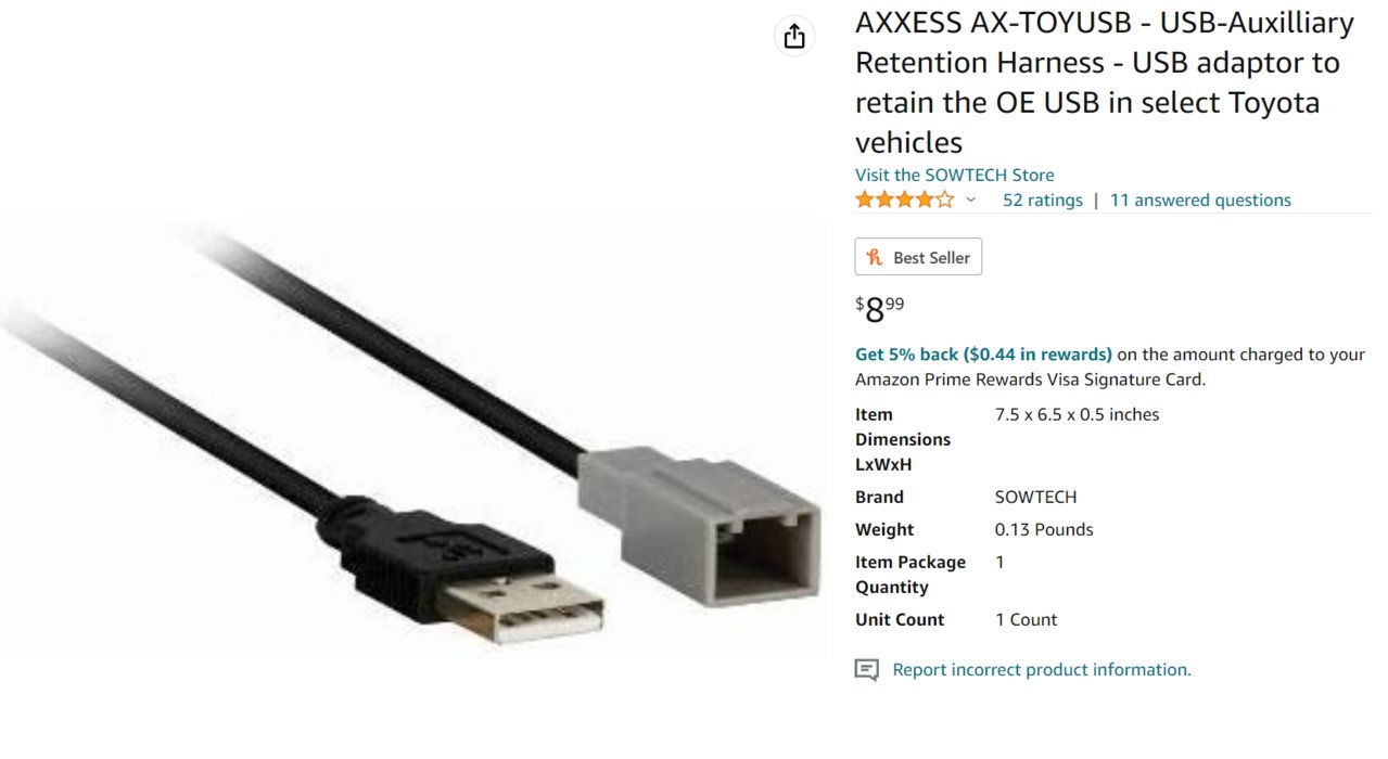

    BUT ... I also needed these:
    The USB connector on the back of the head unit is a USB-C, so the Clavoop adapter plugs into it, the AX-TOYUSB plugs into that, and then the stock USB harness plugs into that. The connection was pretty snug, but I added some electrical tape at the junction to keep the two together.
    Bonus: stock USB port works as expected (honestly didn't try the aux, because who needs it), PLUS it charges my phone. I've already got a charging cord routed around the dash liner to a phone mount, so not 100% necessary, but nice to have as an option.

    The Maestro wiring diagram is ... a little busy, and kind of daunting. The one nice thing I will say is this - all of the plugs are uniquely sized, so I don't think you can plug the wrong thing in the wrong spot. Take your time and it all kind of comes together. With my truck configuration, there were a couple of connections labeled "NC", and those didn't plug into anything.
    One thing that's not super clear is what to do with the powered antenna lead. There's a female spade connector attacked to the Maestro harness, and the smaller lead on the Metra adapter has the insulation precut. I didn't have any spade connectors, so I just got the end off the Maestro side and spliced the two together. That was literally the ONLY wires I had to splice. The Maestro ACC-HU-SON1 plugged directly into the Sony head unit, the Maestro harness plugged into that, the Maestro itself, and the factory wiring. It seems like a crapton of wiring, but honestly, the factory head unit is so big that there was plenty of room left.

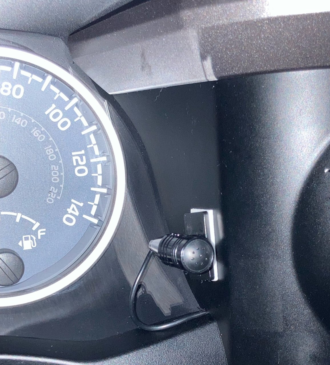

    One odd thing I did run into was the microphone. It comes with a clip mount and a flat mount with 3M tape. I didn't like the way to clip mount felt, and the 3M tape would NOT stuck to the inside of my truck for anything. I bought some heavier duty stuff and got it to stick, but it's still not quite as secure as I'd expect. Anyone else ever run into anything similar? Starting to wonder if the dealership used Armor All on the interior or something before I bought it, heh.

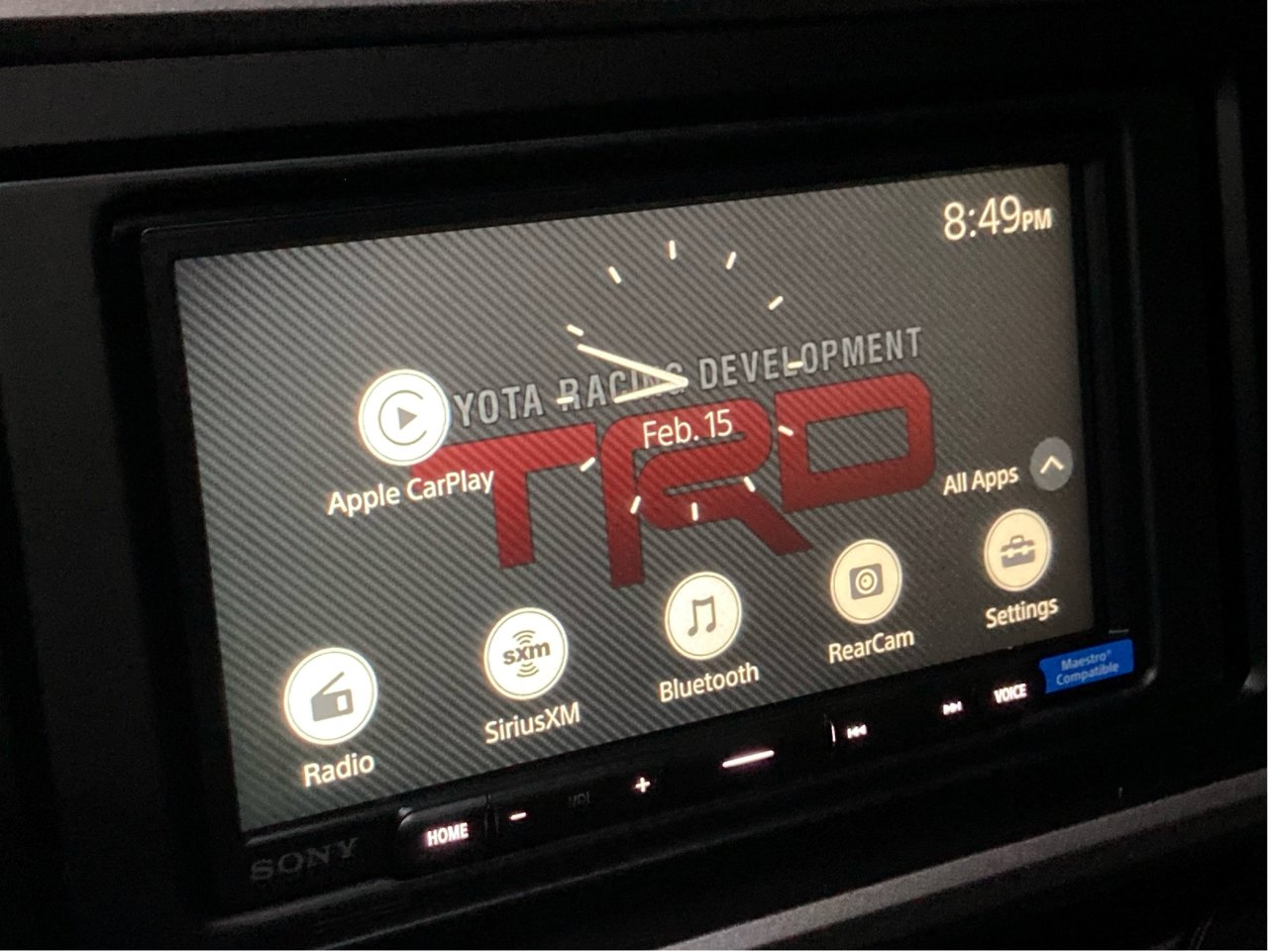

    Also - changing the wallpaper to a custom one was as simple as loading it on a thumbdrive, installing that in the factory USB, and selecting it on the touchscreen. Same goes for the firmware, and I would recommend updating as the one that come on the Sony out of the box was pretty old.

    More pics. Wallpaper:
    Microphone location:
