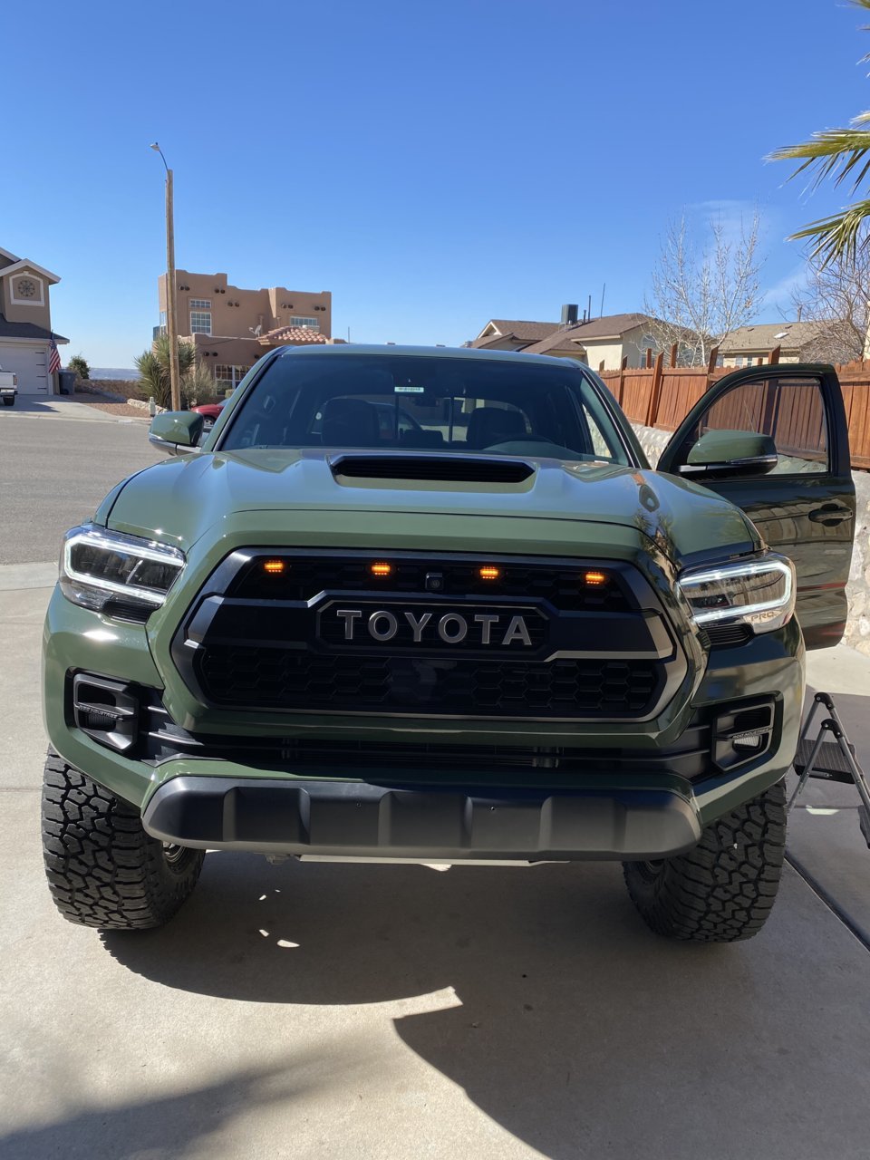

    I got it going thanks to @caribe makaira
    I ended up using a different diode meanwhile! It's a little bigger.

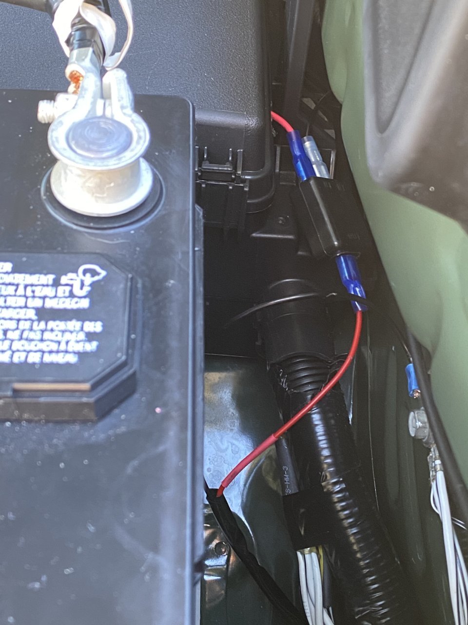

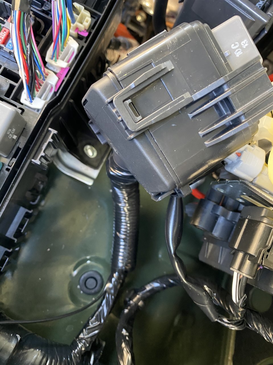

    Long story short I ran a wire from the DRL relay pin 5 (opened relay and tapped from bottom) with a 5amp inline fuse to one part of diode, then I ran addafuse from low beam left fuse inside main fusebox to other side, and out to grille light power, and grille light ground to ground.
    So now my grille lights turn on w DRL during day
    On w headlights at night
    off if I switch lights off completely.
    I know it seems like a lot of BS and I could have just had them on all the time, but I wanted the ability to turn them off. I have been in situations late at night where I have to roll away unnoticed :spy:
    I know this may be useless to 99.99% but it is exacty what I needed! Again a huge thanks to @caribe makaira for the countless diagrams he sent me privately too!

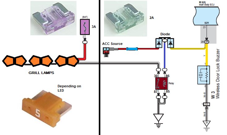

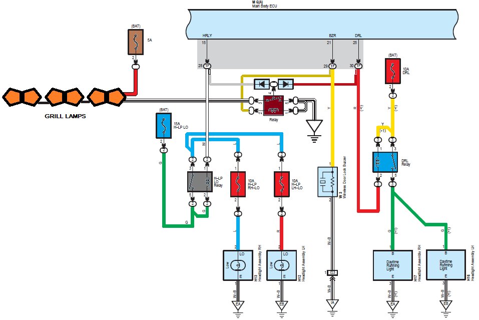

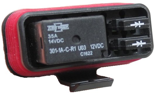

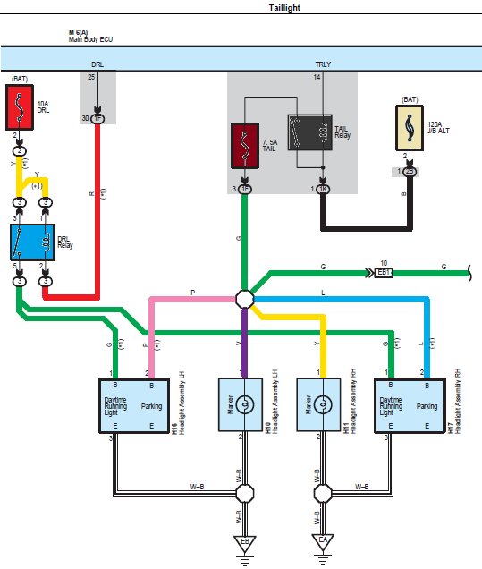

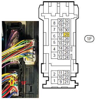

    Have a few permutations of same effect the OP needed.
    This one is overbuilt, but safest electrically. It's handling the coil side (very low amp) of the actuation, minimizing the electrical gremlins the 3rd Gens like to get. Also if one decides to add additional lamps with the Grill Lamps it makes is easy. (parallel to the Grill Lamps on the relay)
    Here you are switching the Grill Lamp ground.
    The added changeover relay provides ground via pin 30 & 87a to 2 diodes.
    One diode taps the DRL relay ground the other diode is to the Headlamp relay ground.
    The diodes prevent the grounds to mate, so when DRL are ON the Headlamps stay OFF.
    The relay has pin 87 & 85 to ground.
    Pin 86 is tapped into the UNLOCK/LOCK buzzer power. When unlocking/locking the Grill lamps flash with the buzzer beep.
    All this inside the cab with only the ground wire coming from the grill lamps.
    This a fancy assembly...or you could just use tape.
    Here is a simple one, sort of. Not doing the effect the OP needed, but for others interested in getting the UNLOCK/LOCK flash.
    bulleit95 likes this.
  14. Jan 25, 2020 at 7:17 PM
    #94
    caribe makaira
    caribe makaira Well-Known Member
    Feb 13, 2011
    #51121
    11,785
    Caribbean, Puerto Rico
    05 PreRunner TRD Offroad AutoTrans
    Hood Struts, My version Fogs always ON, Map & Overhead Light Mod,

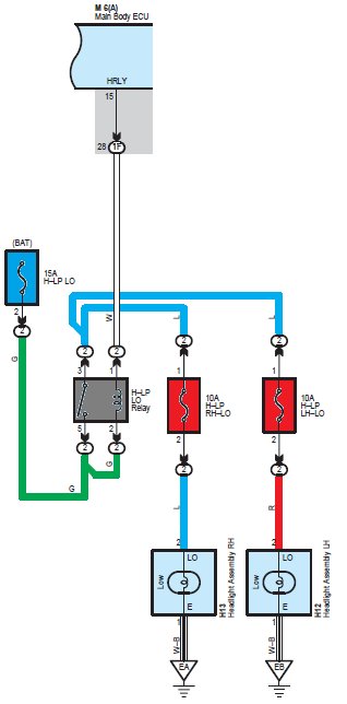

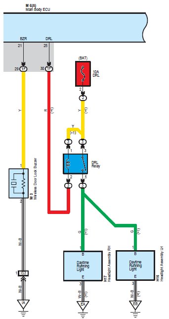

    Details:
    Low Beam Headlamp and DRL circuits. Notice the always hot fuse (BAT) to relay and the ground actuated wire to the Main Body ECU.
    The Main Body ECU provides (+) power to the Wireless Door Lock Buzzer.
