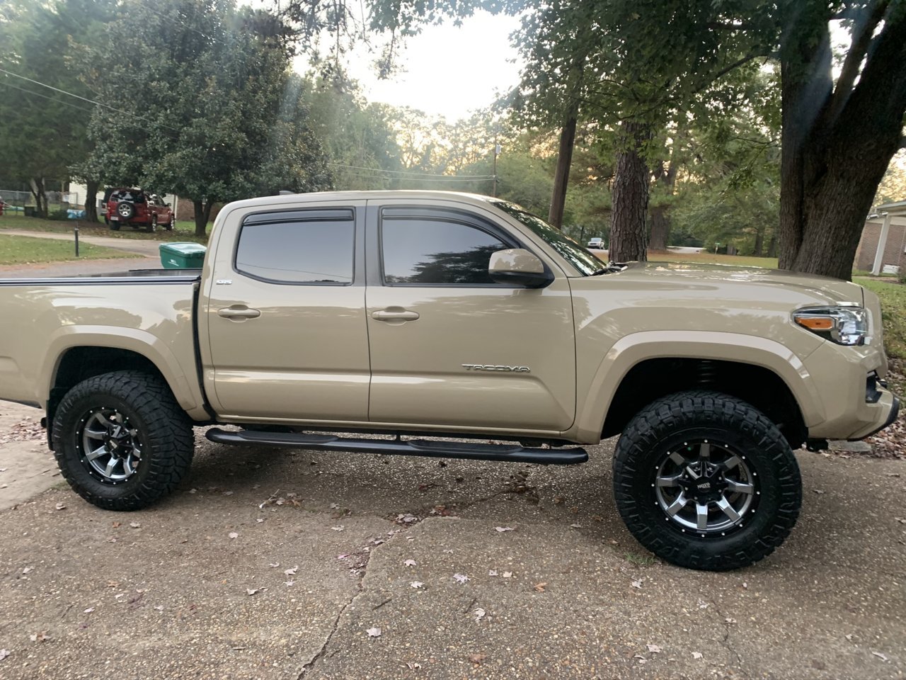

  10. Jun 16, 2021 at 7:53 AM
    COOXDREAM
    COOXDREAM Well-Known Member
    Oct 17, 2020
    #344079
    55
    David
    2016 Tacoma
    I just bought the truck not exactly sure of the mods.
    Hello All,
    I’ve got 33 12.5 R17 muddies ( they came with truck when I bought it).I’m considering going to 10.5 all terrain. What other ideas can y’all add?
    Thanks
