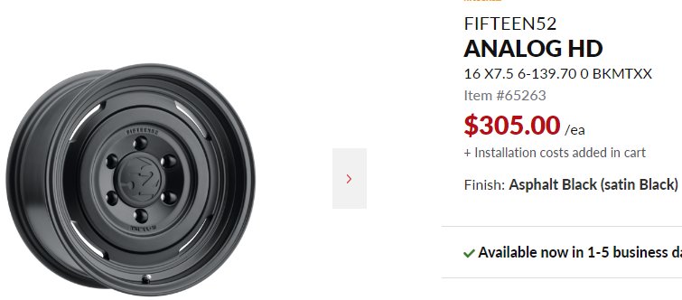

    @tulsamerican if your factory off set is 25-30 and you go to a 0, you would poke the assembly out by approximately an inch and should give you clearance. Take a look at the Fifteen52 Analog HD. It looks like a steel wheel with the benefits of aluminum.
