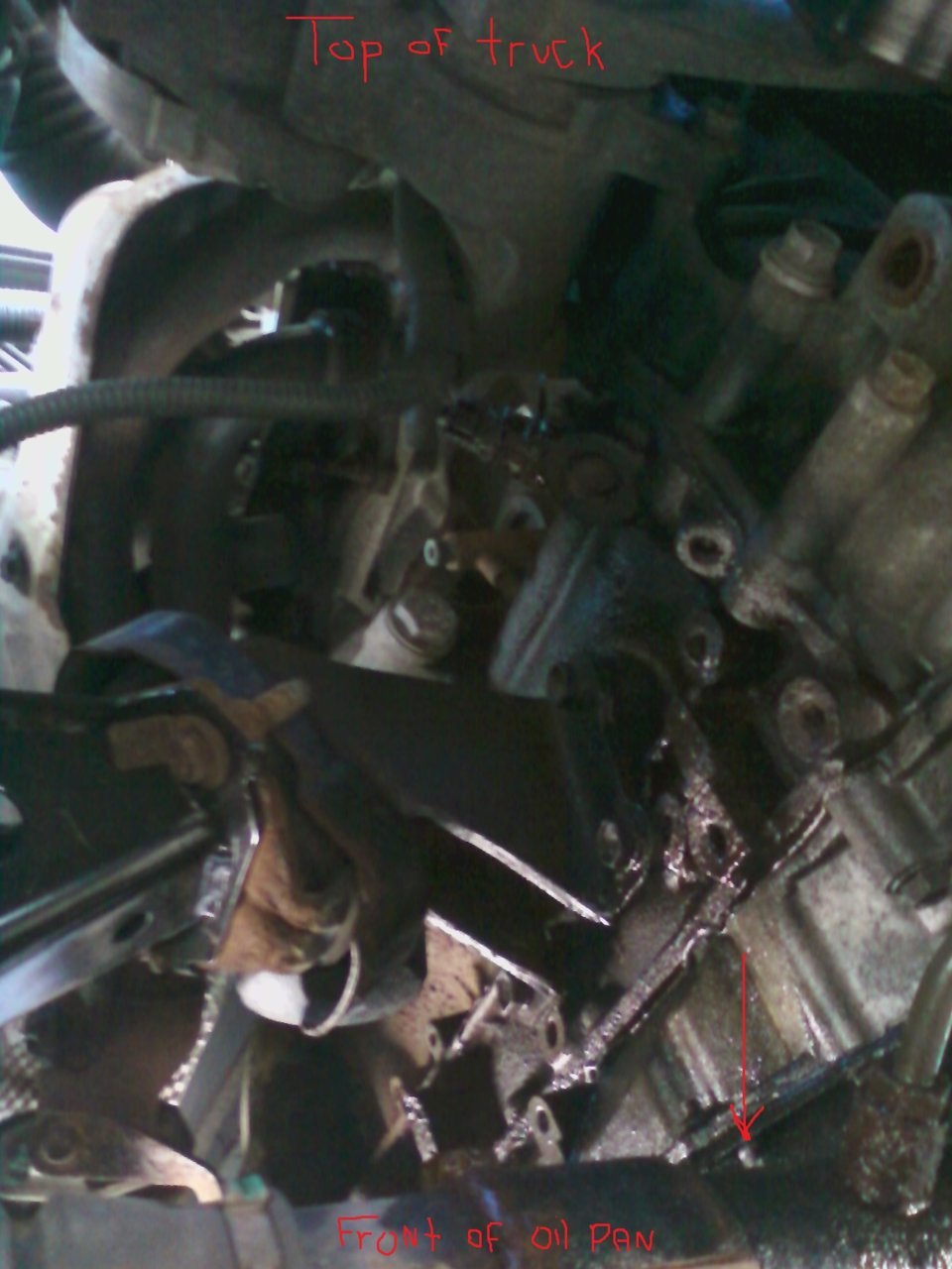

    2005 tacoma 4 cyl
    I have a 2005 tacoma 4 cyl and its leaking oil right above the front of the oil pan on the right side. Does anyone know what this may be leaking from? Ive attacked a pic any help would be appreciated. I hoped it was coming from the oil pan but climbed under there and its leaking from above the oil pan.

    If it's similar to the 1st gen taco 4 cylinder, where the oil filter mount bolts to the block there is an o ring that goes bad and leaks on the right side of the engine.
