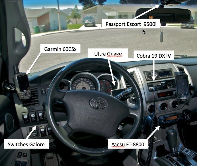

    I am running a Larsen 2/70 NMO antenna and a Yaesu 8800 that I bought off of eBay for $250. It's a great setup. I talk to people regularly from Hawaii to Boston. The other day I made contact to somebody from South Africa.
    If you dont need a dual receive, a Yaesu 7800 would be good. Are you going straight to 10m?
    Here's my setup. NMO is on my roof.

    i think im going to get a Yaesu radio. ive been reading up on them and i found them to be pretty legit.
    im about to check out your sig here in a second
    i really like the size of your unit. the yaesu 8800.
