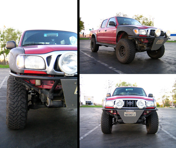

    01 Tacoma DoubleCab V6 Prerunner
    Engage Offroad long travel front and rear with some fat tires.
    the key to fitting the 285s is first backspacing on your wheels... look into a 16x8 wheel with 4" backspace or less... that will help keep the sidewall of the tire away from the spindle/UCA, and the lift helps keep the sidewall from rubbing against the frame during normal driving...
    with the smaller backspace, you can also throw on some 3.5" fiberglass fenders and hammer the pinch weld in to prevent rubbing in those spots...
    next, when you get the truck aligned, see if the shop will set your caster around 2 degrees forward... 1.5 degrees is a happy median...
    there are a number of guys running it with the stock fenders and seem to only rub during articulation... considering you will likely flex at slow speeds only, the rub is bearable...
    before going LT, i cleared the stock UCA and spindle just fine with an aggressive 285 like the Cooper STT...

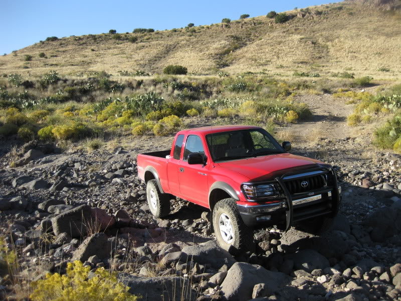

    03 Tacoma TRD 4WD 5 spd
    I had 285's on my stock wheels (2003) with no spacers for a short while. They only rubbed when steering was at full lock (on frame) and at different places on frame when in articulation. I had ~2.85" lift up front.... The rub was NOT significant. Only downsized due to fuel economy.
