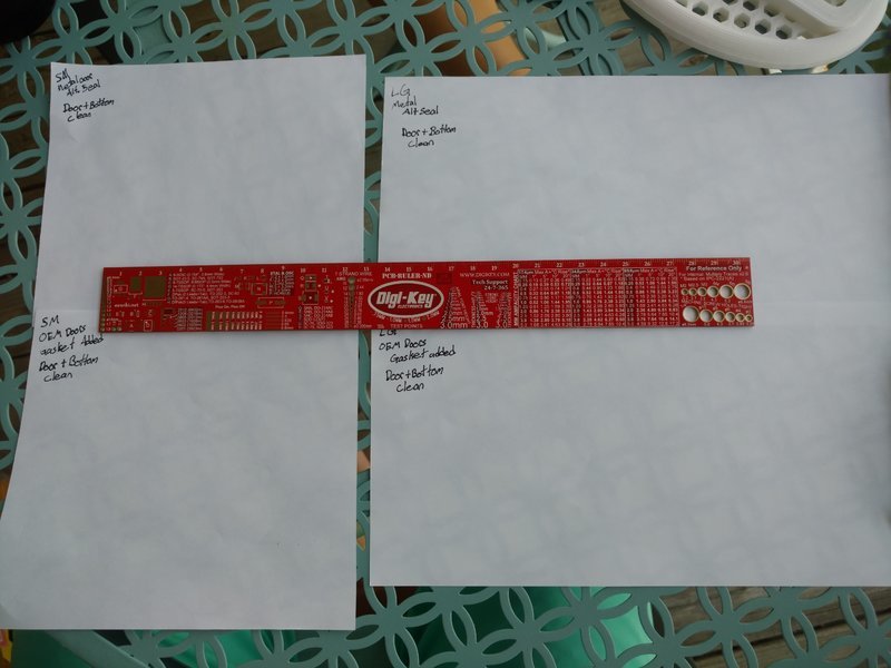

    So yesterday I did some testing to make sure that everything would stay dry no matter which way the water hit the cubby. I ran tests using both locking metal doors and the OEM doors with my gasket added on.

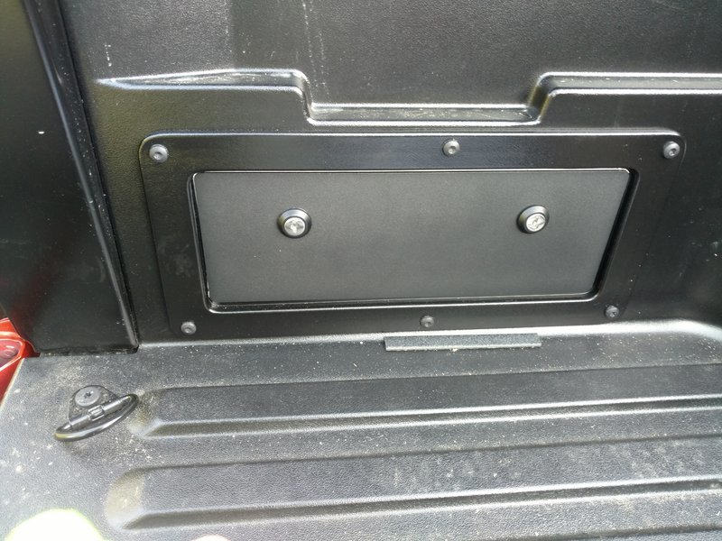

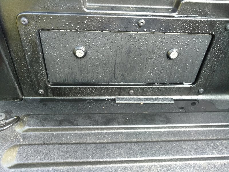

    I used pieces of paper as a gauge to determine if any water got into the cubby.IMG_20170517_175217213_HDR.jpg Then, using a water spray bottle, soaked the doors as much as I could focusing on the edges to test the seals.

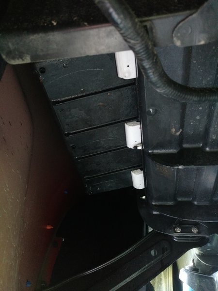

    I also sprayed from underneath to insure that the drain hole wouldn't allow water to get up into the cubby.

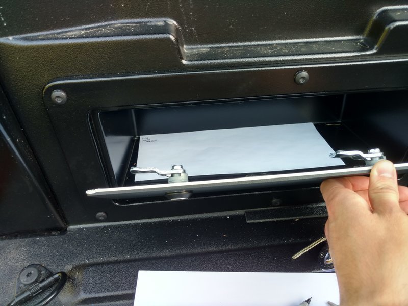

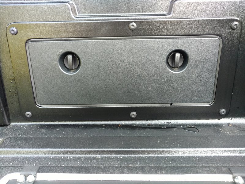

    I did the same process for the OEM doors with the gasket added. I cut the gasket a bit short on the long cubby, so I was expecting to see some water get in through that gap.
    The results of the all the tests are that not even a drop got into the cubbies...
    But, with the metal doors(not saying the company outright) I had to replace the seal that they had provided because the foam tape they included did not prevent water from getting in. I think they would just get saturated then allow water to soak through. I forgot to take pictures when I discovered that issue but, I went out to Lowe's and grab some EDPM weatherstripping and it worked like a charm. (I do have some left if anyone is interested in just getting enough to replace the seals on their doors)
