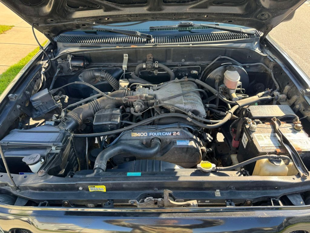

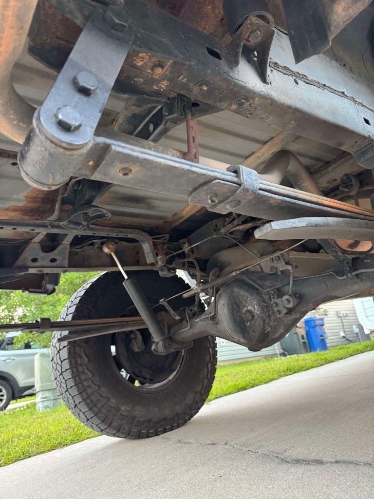

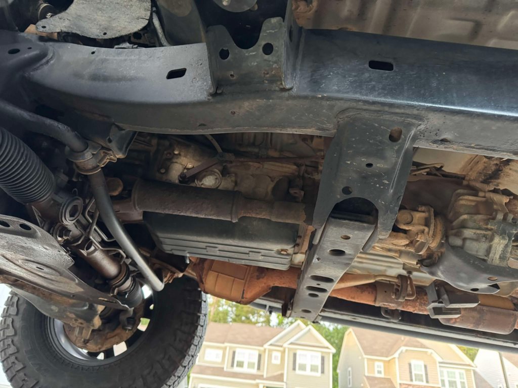

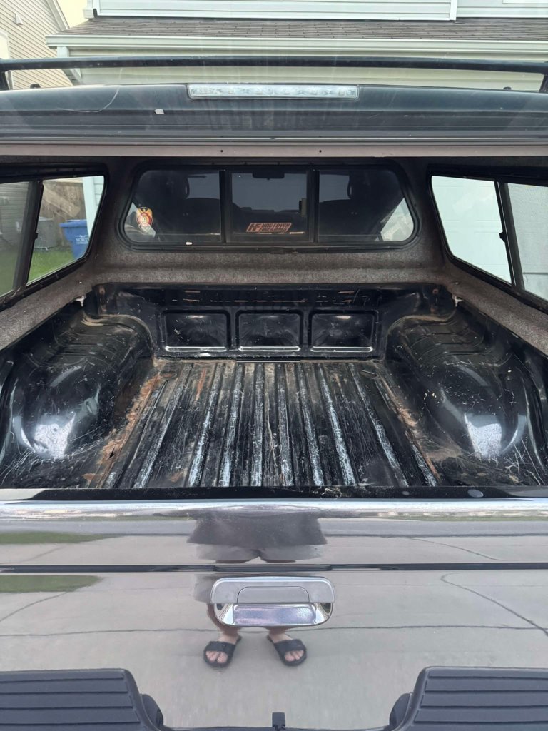

    So here’s one for starters:
    - 2002
    - DBL
    - 3.4l
    - 4wd
    - Rear locker
    - 260k mi
    - 3” BL I know I know.
    - interior is very well maintained
    - FS at $14,000
    TacoSR523 and HondaGM like this.

    Just realized, Looks like maybe a shackle lift in the rear…

    Big things unique to first gens:
    - Frame Rust (Speaks for itself - big safety compromise)
    - Lower ball joints (These fail catastrophically and are a serious safety hazard)
    - Timing Belt (For the 5VZ-FE, the V6, at least it’s a non-interference engine but if it snaps you’ll be stranded cant speak for other engines)
    I’m in the market too these are always the first three things I ask about. I check out the frame and ask when the lower ball joints and timing belt was done.
    Rusty frame is immediate no go.
    Lower ball joints if don’t have service history should be replaced immediately. All kinds of videos on how to do this if you are handy but can use this to talk down the price.
    Timing belt is same as lower ball joints. Replace immediately and use as a talking point to lower the price.

    So the question remains, are you buying or even considering what you see here?

    That frame looks like it's been painted or coated
    Need to go over it w/ a ball-peen hammer and look for soft spots
    Even with a good frame that's a sub-$10k vehicle

    Would you buy it?

    Bwise post is perfect checklist…
    I got a 1997 4Runner about a year ago and this is all I had looked over.
    Agreed on the posted one… at least 4-5k too much $ for what it is.
    I wouldn’t go over the $10k mark.
    I wouldn’t touch a frame that has been coated with a rust cover up product or something. Only paint or the oil type.
    I’d personally look for as stock of a truck as possible.
    Also depending on where you’re at, don’t be afraid to fly to another state for a good one.
    I’m in the southwest so I’m pretty lucky, most every 20-30 year old Toyota here has a good frame, and 75% of them are owned by enthusiast that have kept up on maintenance.

    It does, doesn’t it? In one of the photos it has a very fresh black coat on it

    Too much rust for me.
    I also wouldn't worry too much about other's opinions on the cost of the truck, just as long as it checks all the boxes for you. I'd buy a 2001-2004 regular cab 4x4 with low miles and no rust for $20K+ if I had the opportunity.:eek:

    This, that frame has been painted, hes trying to hide the smoking gun....
    EVERYTHING around it is falling apart, but the frame is black........:frusty::goingcrazy:
