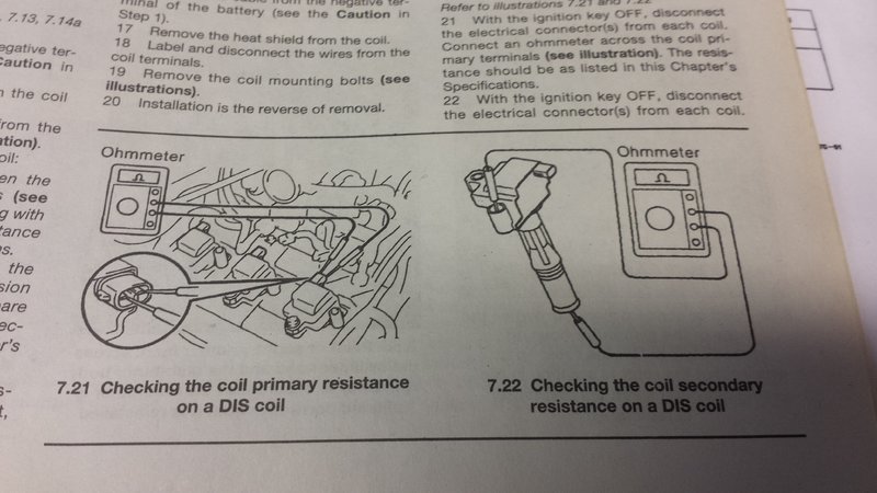

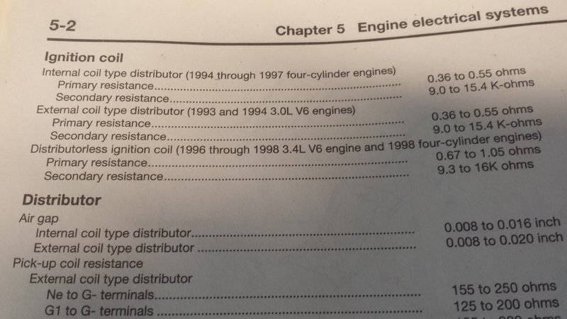

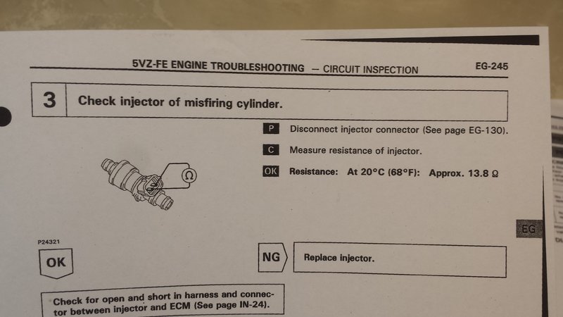

    Coils & injectors are pretty easy to check with an ohm meter. I had a bad injector & it did similar stuff when it was cool it ran fine then hot it would studder/ jerk badly but it would only thro a code for a couple minutes.
    Wait until its doing it and unplug an injector and ohm it. They have a value at a certain temp but that doesn't really matter.
    Your just looking for one that has a way different value. So mine were like 21 hot and ten when I got to the bad one it was like 3. I waited for them all to cool and they were all like 3. So I replace that injector & its been running fine.
    Test the coils similar. Five O motorsports is where I got my injector.
