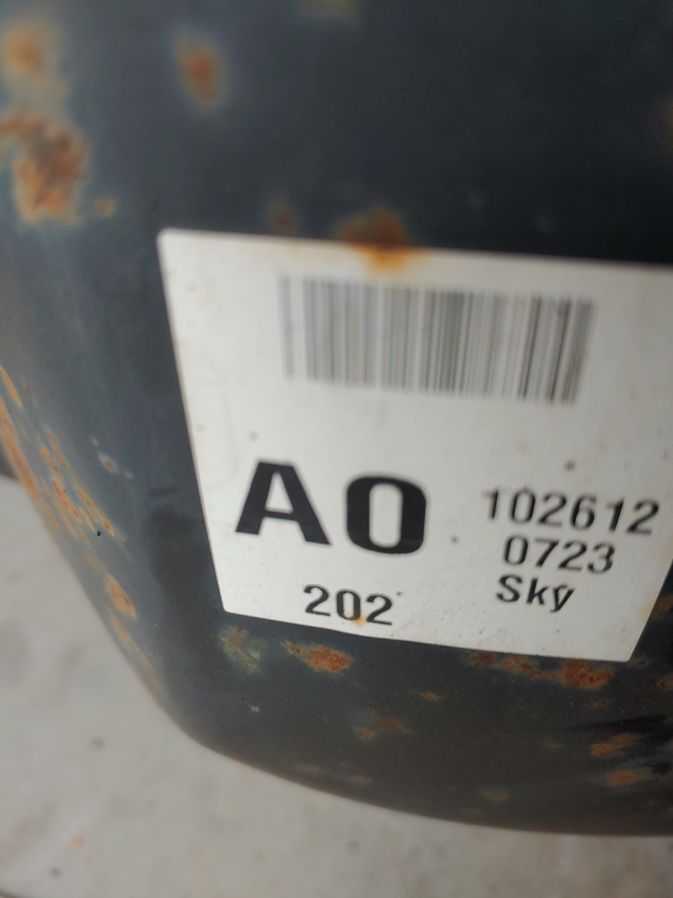

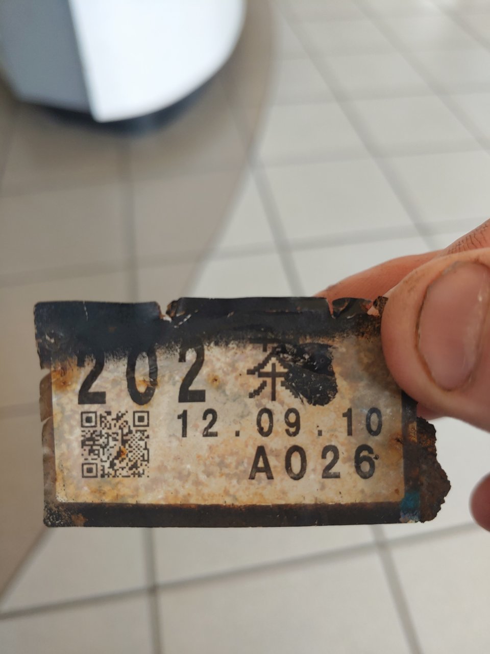

    Picked up this rear axle and I am trying to identify gear ratio. Was told it was a 3.73. All i have to go by are the two stickers on the axle.. any help would be appreciated20210313_170319.jpg 20210313_111903.jpg 20210313_111903.jpg 20210313_170319.jpg 20210313_111903.jpg

    Just rotate the hub and count how many times the pinion spins.

    Simple.
    Place the rear axle on jack stands.
    Rotate the wheels 1 revolution. Count the number of times the diff input flange turns.
    Those stickers may only be identifiers for the axle housing. No relation to the gears inside.
