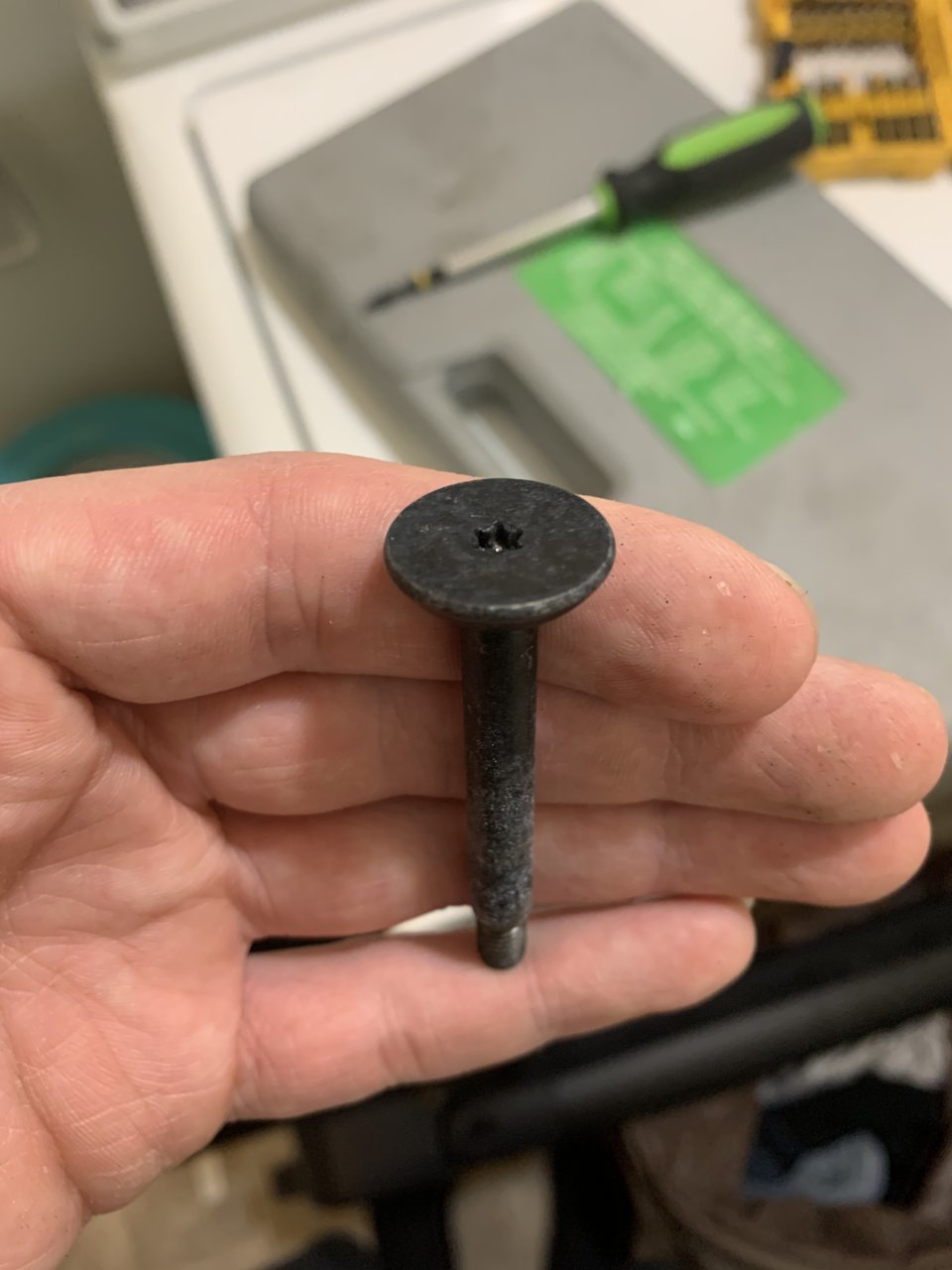

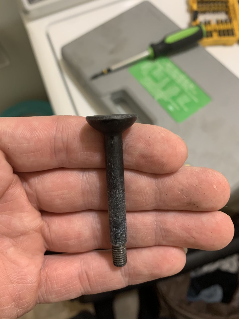

    I bought a second hand roof rack for my 2009 taco and I am missing one of the bolts that secure the cross bars at one end (quick release on the other end). I am having no luck tracking one down either so hopefully somebody can help, thanks in advance.

    I tried my best to look for you.
    Best I got was in the links below. Which never lead me to a parts kit or the bolt.
    The parts list says it’s an M6 size.
    I believe it’s called the hinge screw.
    Here is a link to the part #’s.
    I had no luck finding the screw kit.
    Maybe you can do better than me at finding it.
    https://www.tacomaworld.com/threads/roof-racks.315906/#post-8201298
    The only thing I found that looks close is one for a Subaru and it too is an M6 size.
    What I don’t know is the head diameter or the length. But it sure looks close.
    https://parts.augustasubarudealer.com/p/Subaru__Outback/Stopper-Pivot-M-6/60250061/91172AJ01A.html
    Here is install instructions that list it as an M6

    The link you sent looks to be the exact bolt, I may just order it, give it a shot and report back

    Finally received the bolt for the roof rack and it’s a perfect fit, threads right into the square nut that comes with the racks. Thanks for all the help!
