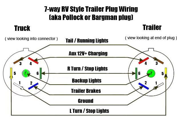

    Your wiring should look like this. Anything different won't work.
    Captqc and burlow[QUOTED][OP] like this.

    Don't make any wiring changes to the Truck. I bet that the red and blue on the trailer plug are reversed.

    If you find the meter or test light check out the diagram in post #7, once you check the truck plug on to the trailer plug. Very slim chance that it's the truck plug but stranger things have happened!

    99 percent chance it is the trailer plug wiring.
