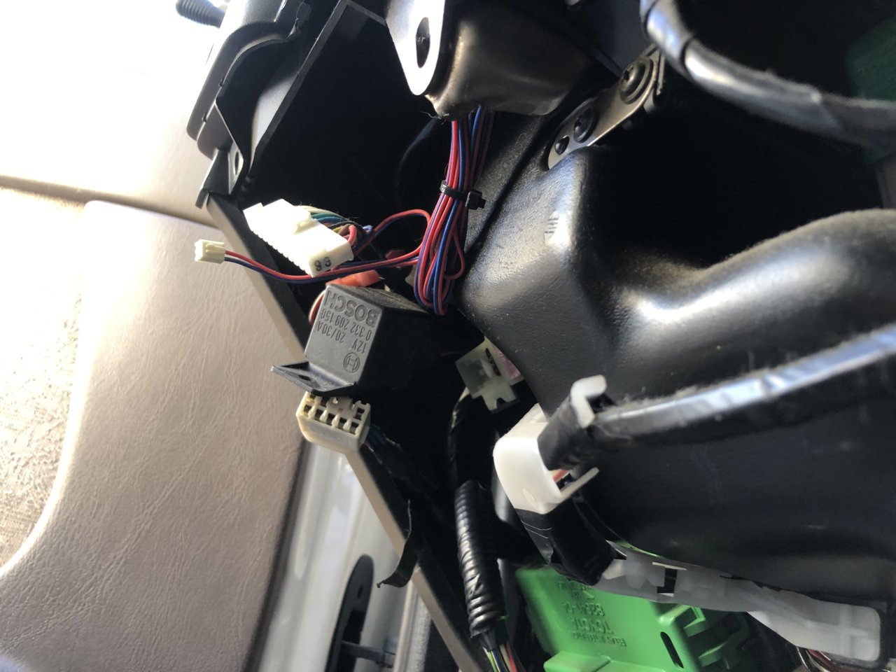

    I’m trying to remove my alarm system it’s aftermarket and I want it out, does anyone know which wires I should unplug?
  2. Dec 17, 2021 at 12:01 PM
    Glamisman
    Glamisman Well-Known Member
    Oct 22, 2016
    #200436
    4,665
    follow the wires off of the relay, they usually lead to the bundle of wires that come off the electrical portion of the ignition switch. In my experience, all the relay does is open or close the circuit for the starter.
  3. Dec 17, 2021 at 12:27 PM
    Tacoboy1
    Tacoboy1 [OP] Well-Known Member
    Sep 10, 2021
    #376771
    91
    Nathan
    Southern California
    2000 Tacoma 92k miles
    Is this the relay?
  4. Dec 17, 2021 at 12:28 PM
    Glamisman
    Oct 22, 2016
    #200436
    4,665

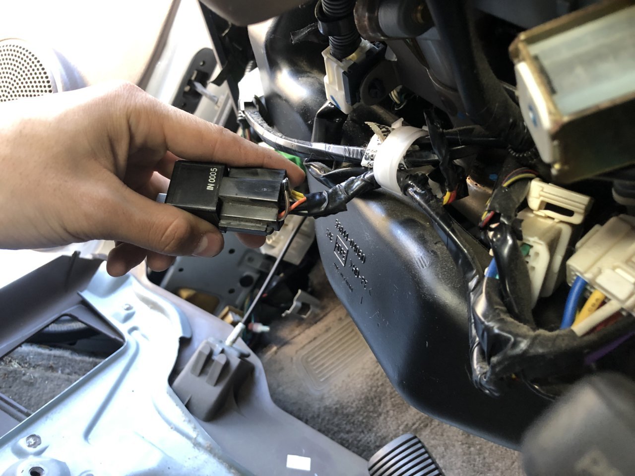

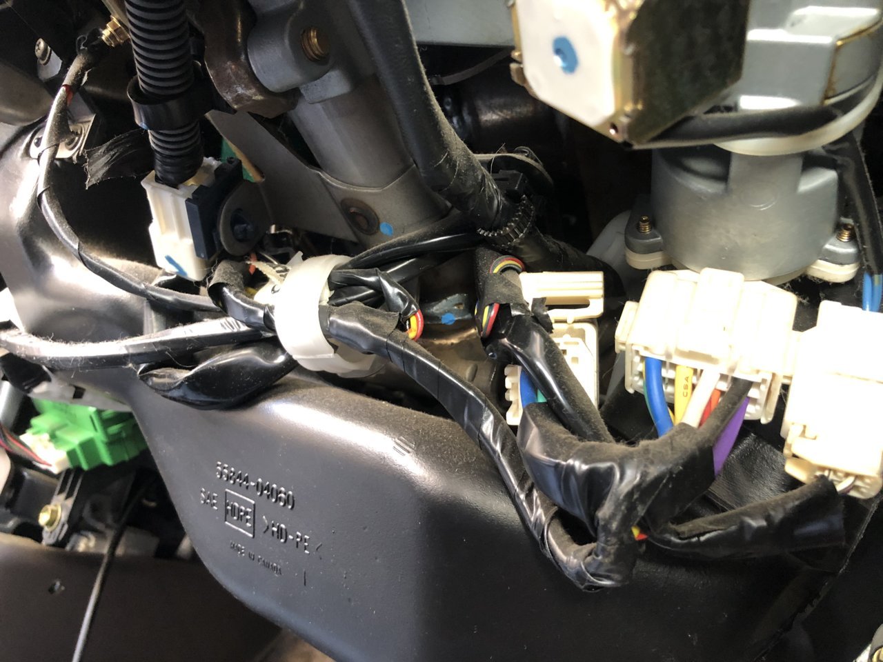

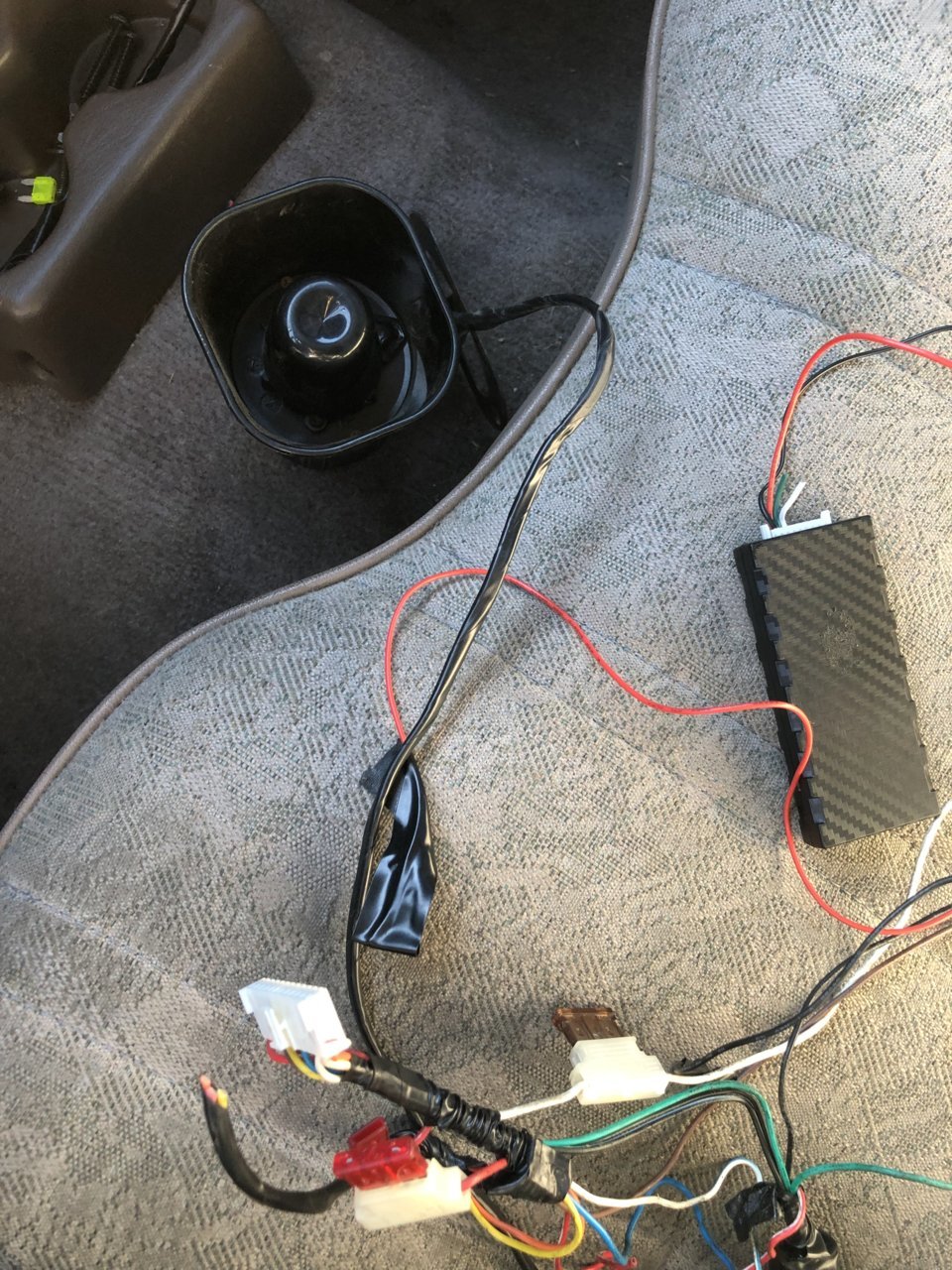

    I cut the wires connecting to it
    Can you let me know how I’m doing so far

    Also do you know what this is? It was just hanging there

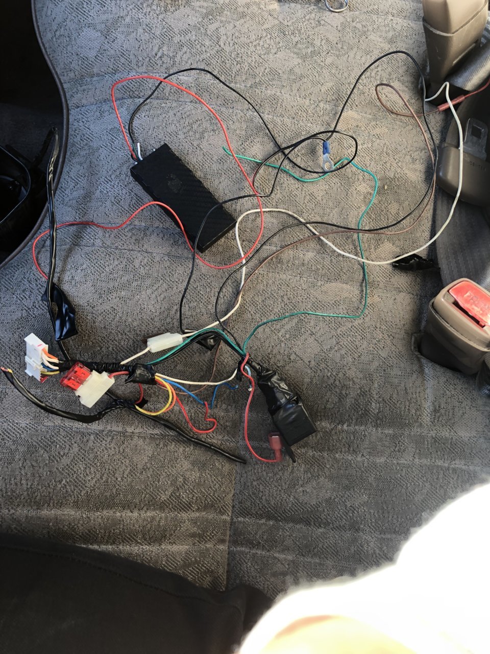

    Didnt start that’s why I wanna take it out

    Likely an option you don't have... power windows, locks maybe?
  10. Dec 17, 2021 at 1:11 PM
    Tacoboy1
    Sep 10, 2021
    #376771
    91
    Nathan
    Southern California
    I do not have power windows or locks, all manual

    well i would have looked for the starter wire since all alarms disable the starter. just cut it from the alarm and connect it back together. just removing the alarm won't make it start again.

    yeah some alarms are out dated but as a person who used to install alarms, if you cut out an old alarm, the starter will be most likely cut and they installed a relay in between so that the alarm can control when the starter is disabled (armed and unarmed) so look for that then the rest you can cut out. i forget which wire is the starter my alarm has been installed for 20 years now. lol
