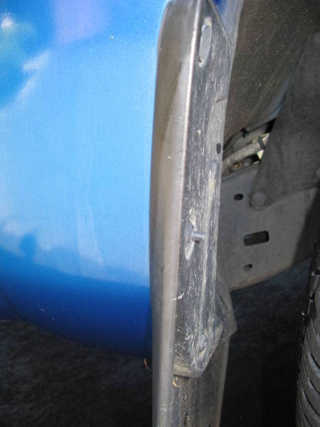

    So I got the drivers side off. Went over to the passenger side and noticed that the three plastic rivit clips are all different?
    I want to take them out with as little damage as possible.
    Top: regular one (I know how to get this one out)
    Middle: some wierd looking one, the thig sticking out appears to be threaded.
    Bottom: Looks like the middle one, but no thing sticking out.
    Thanks in advance!

    looks like an actual rivet and not a plastic fastener.
    you may have to drill it out

    They look like the kind that you take a small punch or phillips and gently punch the small center peice in. Then the whole thing just pops out.

    no i tried that. im leaning towards sockmonkey, there pretty solid

    alright they were definitly rivits. I just pulled it out far enough so i could get wire cutters around the base and snip the heads off.

    top bolt
    bottom two plastic rivits
    either pull or push to get centerpin out

    I just did mine yesterday. There are 3 bolts and then 3 rivets. The rivets are two pieces. In order to remove them you have to get a flat head in between the top portion and the bottom portion of the rivet. If you try getting all the way underneath it, the rivet will break.
    Here is a simple drawing
    _
    _ < Stick flat head in hear and lift outward. Then pull it out.
    v
    v
    v
