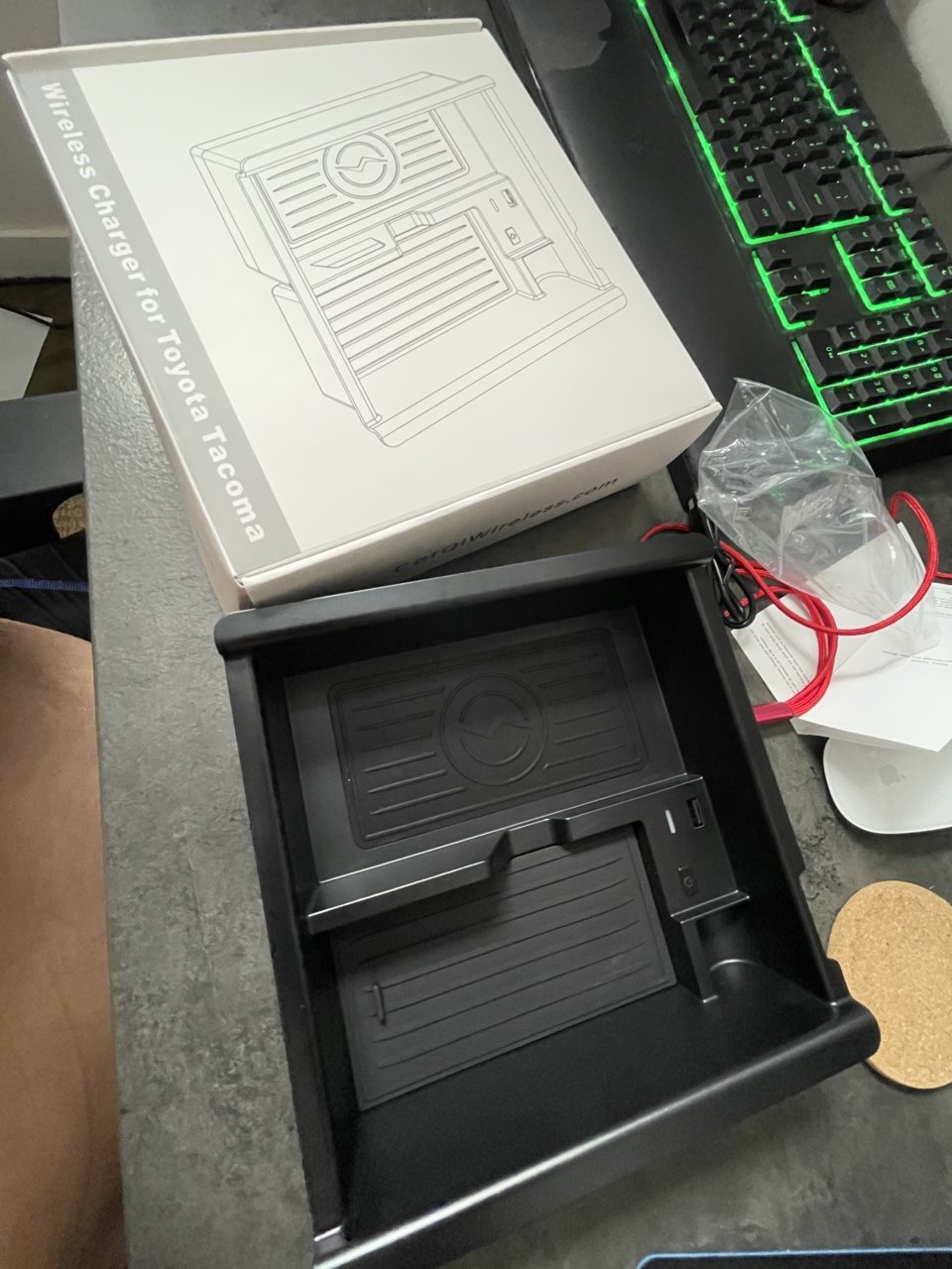

    Wow got this guy in the arm rest and it works perfectly. There’s a wire that connect to inside the cigarette adapter and it charges my iPhone 12maxpro with thick case!

    It does have a button to turn it on and off which is great. But.... It still turns on every time you start the car. Dunno if that's a bummer for you. It does work better than the OEM Qi charger. My phone case on my iPhone 12 promax won't let me charge for the oem location so although I fixed it with the rubber cement the arm rest charging area is still the winner for me. The other thing I do like about this little tray is that it's actually .5" deeper than another brand tray I bought on Amazon. More useful in my eyes. Also the wire is not perm fixed to the tray it's actually a usb c plug on the bottom which is also a plus because you can put any length wire you like. Hope that helps.

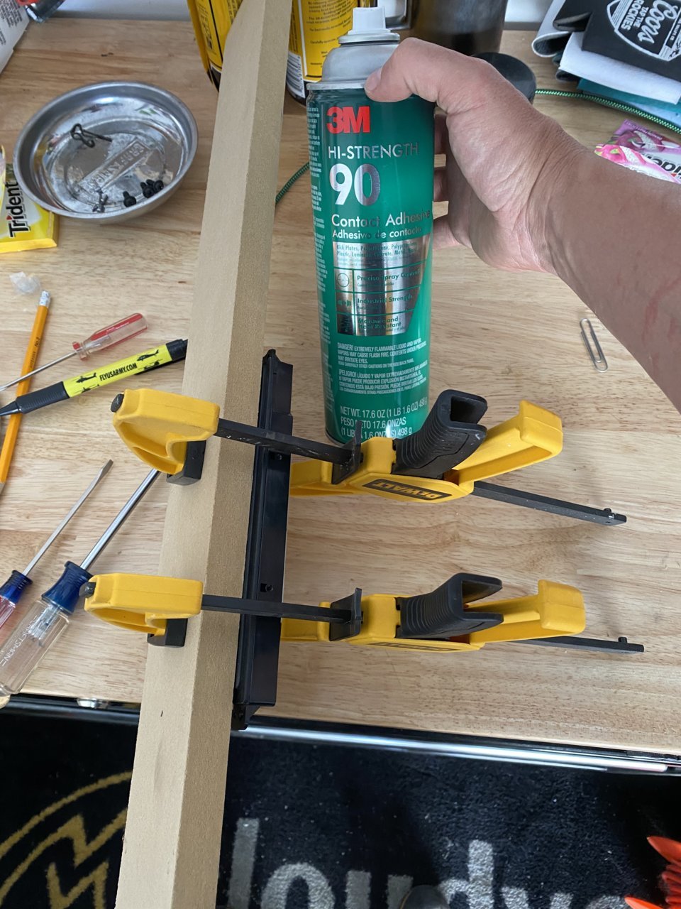

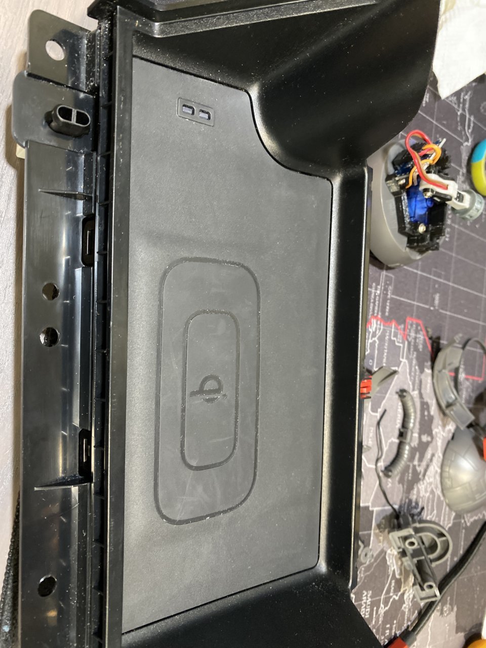

    So I just did the same, going to let it sit over night. shockingly easy to get out of the truck. Honestly hardest part was the little push down clip on my shifter knob was stuck. We’ll see how the spray adhesive works.

    so far so good, still heats up more than I’d like. But I’ve also installed a DMM so I’m not using it nearly as much, but that damn bubble is gone so I’m happy.

    Exactly! I kept a lot of pressure on it and let it set for probably close to 24 hours and I think that was secret.
