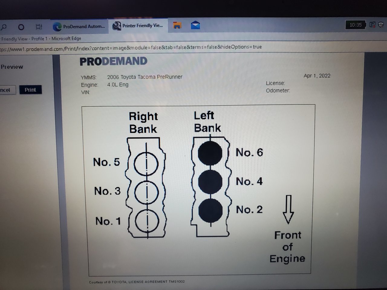

    For us idiots. Bank 2 would be passenger side header converter correct?

    Bank 2 is left (drivers) side.

    Goes by firing order, thanks man.
