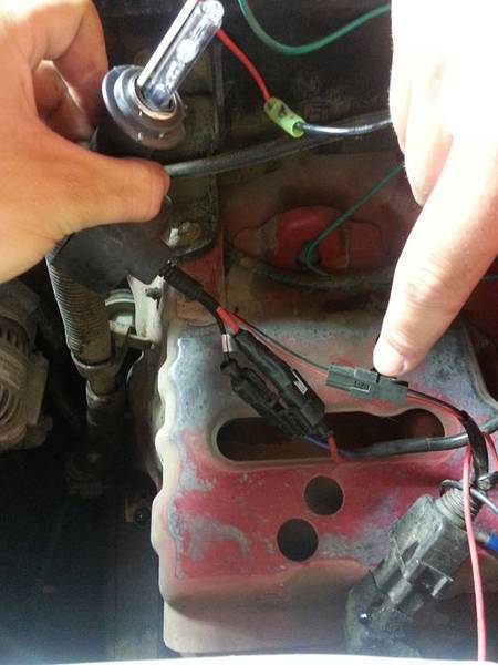

    Hey guys im trying to swap bulbs in my truck. I have the 6000k that came with the lights in but im putting 5000k in from ddm tuning. I dont know what the two small wires are that go into the bulb I have in now. Any ideas? Do I need it? The ddm ones didnt come with it
    Il post a pic in a minute

    That's your high beam solenoid.
    If the new lamps don't have it, you won't have high beams.

    Are the originals a bixenon? Meaning high and low beams? If so that is probably the wire that activate the change to move the bulb out when the highs are turned on.

    Thanks
    Yeah they are. Thanks

    I put the other bulbs in, and they suck. Im thinking because they are only a low beam. Anyone know a good bixenon for H7s?
