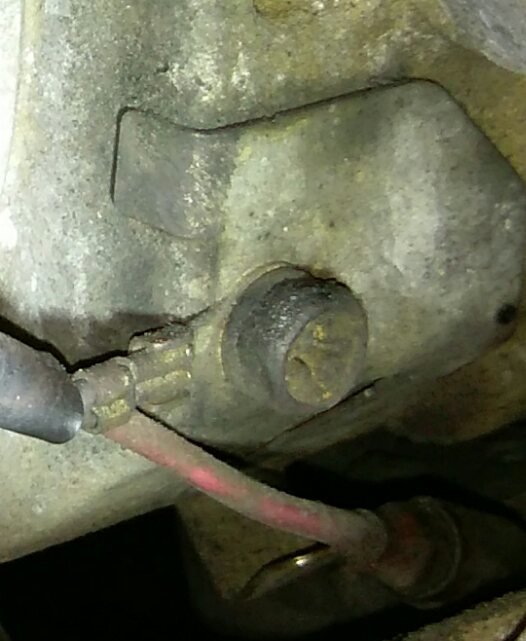

    my 2006 Tacoma 4.0. Question is where would the ground for the compressor be located at ? Have eliminated the relay under the hood. Was also told that serpentine belt could be stretched causing this. Trying to start out with least expensive items before I go into putting electronics that start out with a cost in 90 bux range. A/C is fully charged with Freon

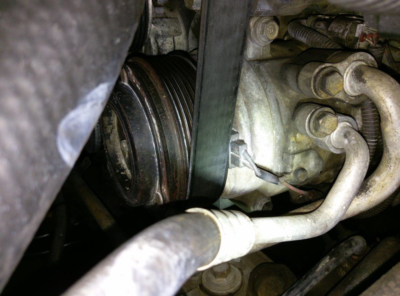

    Really guys, guy asked a simple question. Here is ground wire, on my 2006 pic of mine 5 mine taken 5 mins ago. Ask a friend with gauges, or maybe borrow from autozone check freon before you start openning up the system.

    Thanks for taking the time to post pictures,I greatly appreciate your time
