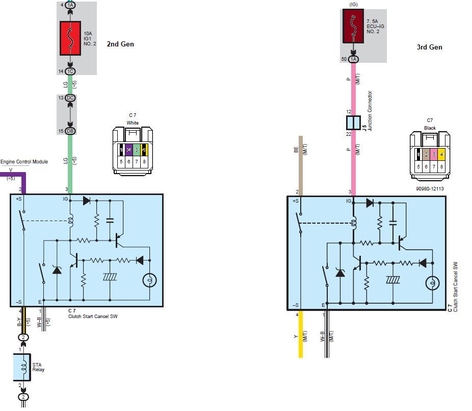

    POWERTHIRST Tuned - My Custom OVTune SSO Slimline Bumper with Stage 2 Kit + BajaDesigns 20" Light bar with Amber Backlight + Smittybilt Winch x2o 10,000lb Synthetic CaliRaisedLED Step Edition Rock Sliders SUSPENSION FRONT A.D.S. - 2.5 Adjustable Dampening Remote Resi Fronts Dirt King Upper Control Arms SUSPENSION REAR A.D.S - 2.5 Smoothie Piggy Back "Rear" Shock With Compression Adjuster Deaver Leaf Pack Cab Mount Relocate by Triple-C Chop Shop, Lago Vista, TX Nitro Gear 5.29 BFG KM3 35x12.5x17 Fuel Rebel6 17" Wheels + Full-size Spare + Rhino-Rack Spare Wheel Strap 4x Rigid Cube Ditch Lights + Cali Raised Ditch Light Hood Mount Brackets + Cali Raised Ditch Light Extension Brackets + 3x Cali Raised Switches + Light Switch Mount Bracket Snugtop Camper Shell with Carpeted Ceiling and Mounting Tracks Prinsu Top Rack and Cab Rack Hi-lift Jack + Hi-lift Jack Mount on roof DEFEND INDUST Recovery Traction Tracks (knockoff Maxtrax) Trimax ST30 Trimaflex Spare Tire Cable Lock (Round Key) 36" x 12mm K&N Intake Canvas 270 RV Awning Rooftop Sun Shelter + Prinsu Awning Brackets Fire Extinguisher w/mount Campbell Hausfeld FP209499AV - 3 Gallon Air Compressor
    Hey all, I've got a set of Rigid LED Ditch Lights installed on my 3rd Gen TRD Pro DCSB Automatic, they're working fine, but they're currently wired to one of those simple red switches (the kind that light up red when the switch is in the "on" position).
    I don't want to cut holes in my truck, so I purchased an OEM "Clutch Start Cancel" button to use instead, as it's the only 'blank' on the dash where I could use an OEM switch. I've got the button and the harness that plugs into the back, and I'm planning to use the existing RIGID wires (as Toyota wants $100 for about 10 inches of OEM wires) installed into the harness, and mounting the button in that blank spot near my left knee.
    My question is about which wire goes where in the harness... I can't find a good wiring diagram for the Clutch Start Cancel button, especially since I'm not intending to use it for an actual Clutch Start Cancel button. I was hoping some automotive electrical geniuses might be able to help guide me!

    there should be 3 wires coming from that switch. the switch hot, the hot for the backlight and the ground. Get some wire, a 9V battery and LED or other small light and hook it up/ play with it until you can get the switch to turn the light on and off. Then you know.

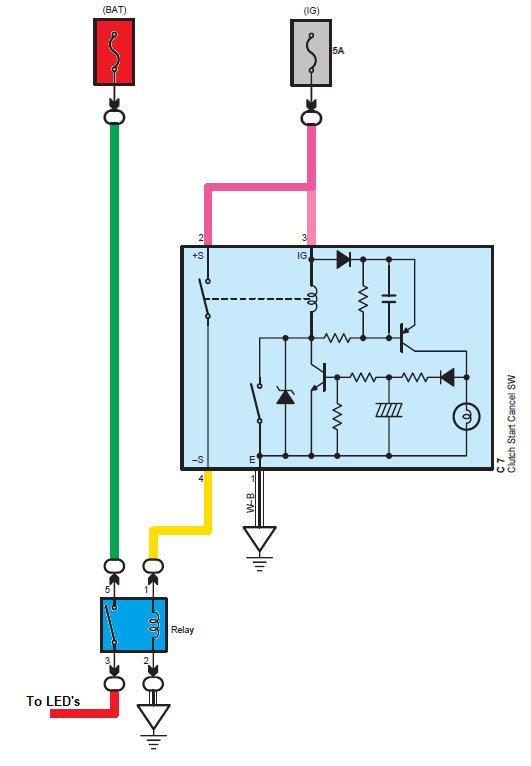

    Thanks for the suggestion @CaliRaisedLed ... after screwing around with the OEM Clutch Start cancel switch and harness (with zero wiring diagrams anywhere), I gave up that idea. Would have been fun to have an automatic Tacoma with a button specific to Manuals, just to mess with people...
    Gunna bite the bullet and get the Cali Raised switch, since A) looks easy AF to install and B) it's cheaper... assuming my dealership lets me return the $40 OEM button, since it's still unused. Wish me luck on that... ordering your switch now!

    Hey, I forgot to thank you for uploading that!
