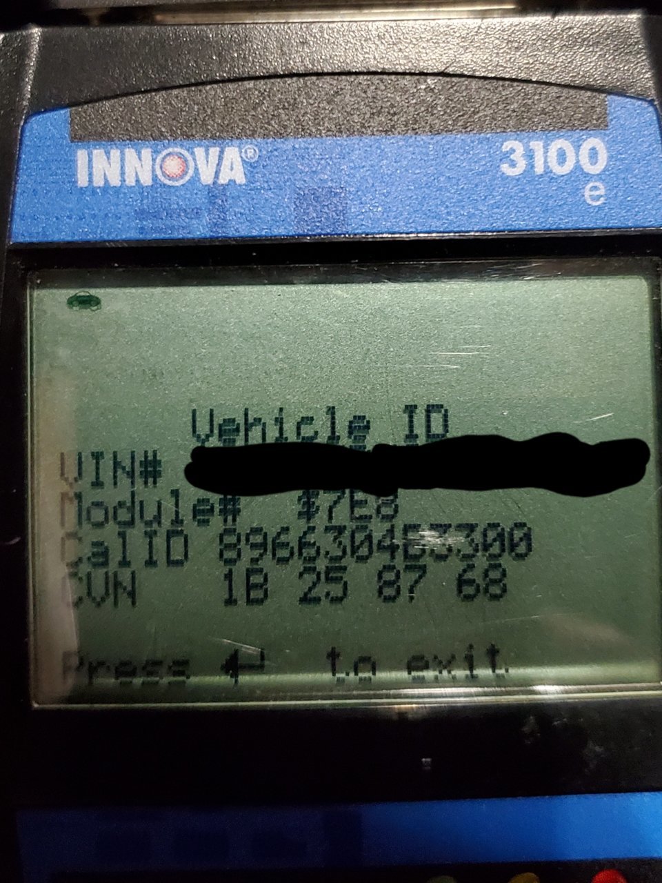

    They never do the sticker. Just check with a code scanner, most will show the calibration ID.

    does a code scanner like the one they’d use at an autozone check it? I don’t have one of those Bluetooth things.

    It might. My cheap one that's over 10 years old does, but it's in a sub menu.

    Thx..so that’s the TSB update 4B3300? I have a 19 too.

    Yep, I did it myself with Techstream and a tactrix cable.

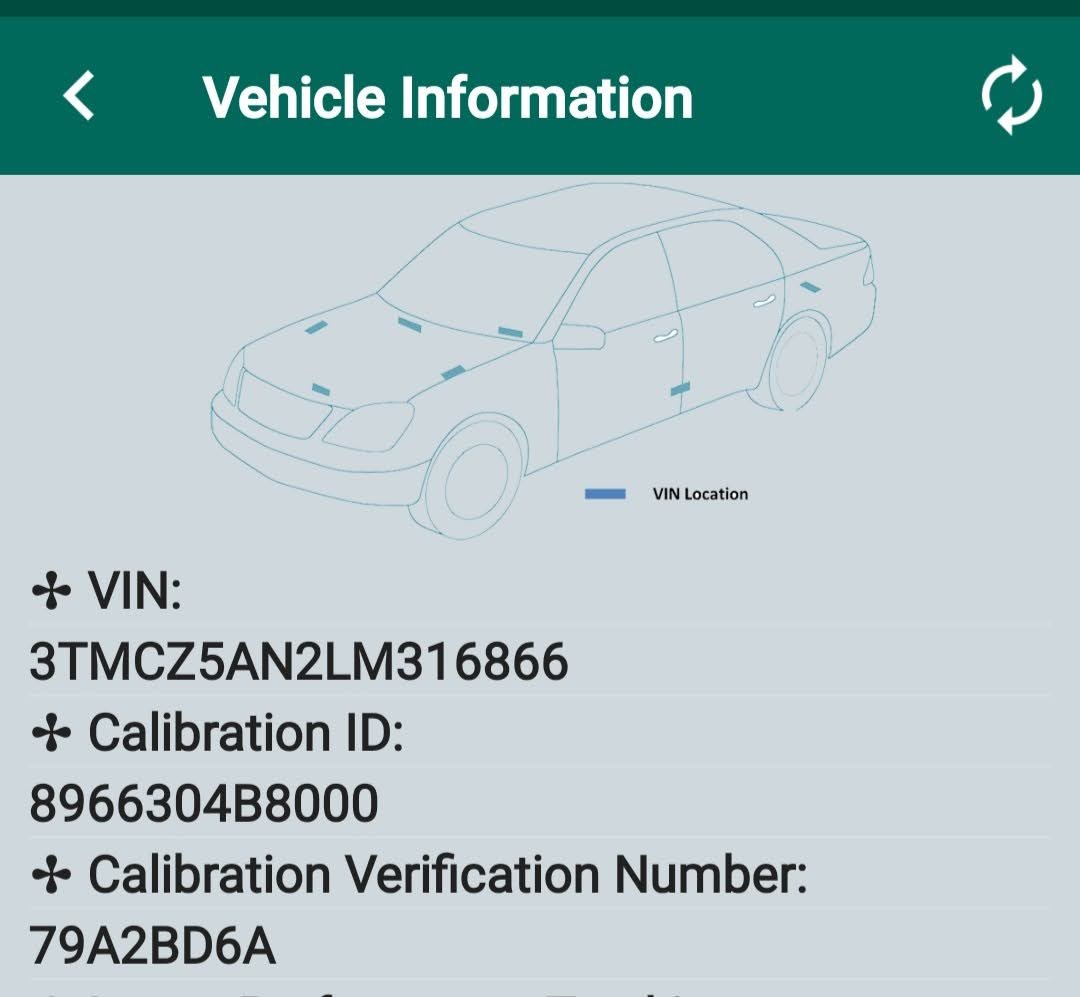

    I'm new to all this, it looks like my truck has an update available via this TSB. 8966304B8000 to 8966304B8100?

    Yes -
    TSB-0092-20 (USA) and T-TCI-5380 (Canada) -- 2019 and 2020 AT Update
    AT ECU ID 04B80 is updated to 04B81 (2020)
