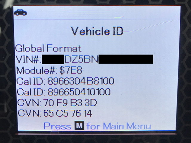

    I have a 2020 Sport Double Cab Long Bed AT...
    I hooked a scanner up to the truck, this is what I see...
    Looks like my truck already has the update that is in question. Correct??
    Thanks in advance for the help

    Yes. You are 04B81 and good to go.
