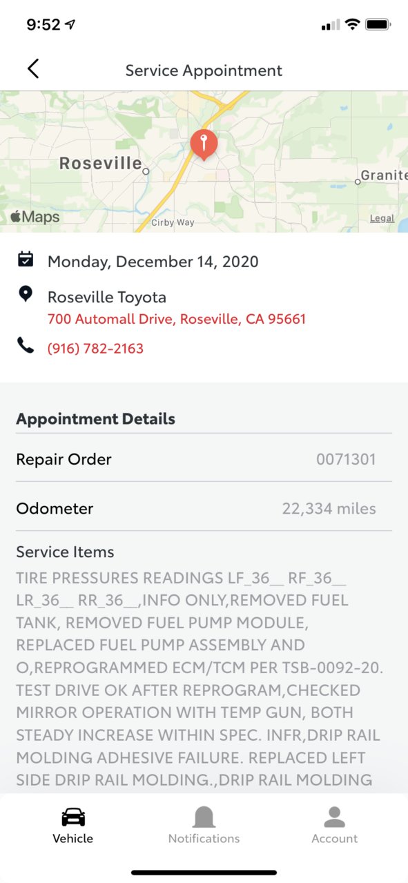

    No questions asked at this dealer if you’re in the Sacramento area. B68F5579-8069-41CA-B6DC-85944E8A5900.jpg

    Had this done today. Not without effort. Hat tip to Toyota Care who stopped a dealer dead in his line of bullshit and got the TSB done. 2019, late 2018 build.
    Took the truck in this morning. Was told "no problem". Got a call 5 hours later at noon - "Toyota won't approve the TSB because we can't replicate the problem".
    I called Toyota Care, was on hold for about 8 minutes and then spoke to a Care Specialist. She listened and then transferred me immediately to a Case Manager (?) who listened to my story, put me on hold for about 5 minutes, then proclaimed that the dealer was full of shit.
    Per Toyota Care, the TSB does not require replication by a tech, it requires two things:
    (1). that the vehicle VIN falls within the prescribed TSB range.
    (2). that the customer has verified an issue as described in the TSB.
    Per Toyota Care, this is not a production issue that may or may not be present in a specific truck, it is a programming issue that affects all vehicles within the VIN range. The only variable is whether the owner has an issue with it. Toyota Care asked specifically for the name of the service advisor and the service manager I spoke to. Asked me if I wanted to open a complaint against the dealership (yes). I also told them that since I was in the giving mood that I had two other complaints for them for past issues. The took them down and sent me case #s via email
    Cut to the chase, 10 minutes after I got off the phone with the Toyota Care Care Manager, the dealer called and said that Toyota has miraculously "approved" the TSB.
    When I went to pick up the truck from the cashier, the service manager came out with the paperwork and said it was a "misunderstanding" and that "the TSB was applied.
    As for the TSB...big difference. I've been driving this thing for two years in S4/S5 mode with ECT. Drove around for an hour in D without ECT and the truck shifts and accelerates 100% better. Holds gears longer and is much less restless. Highly recommended.
