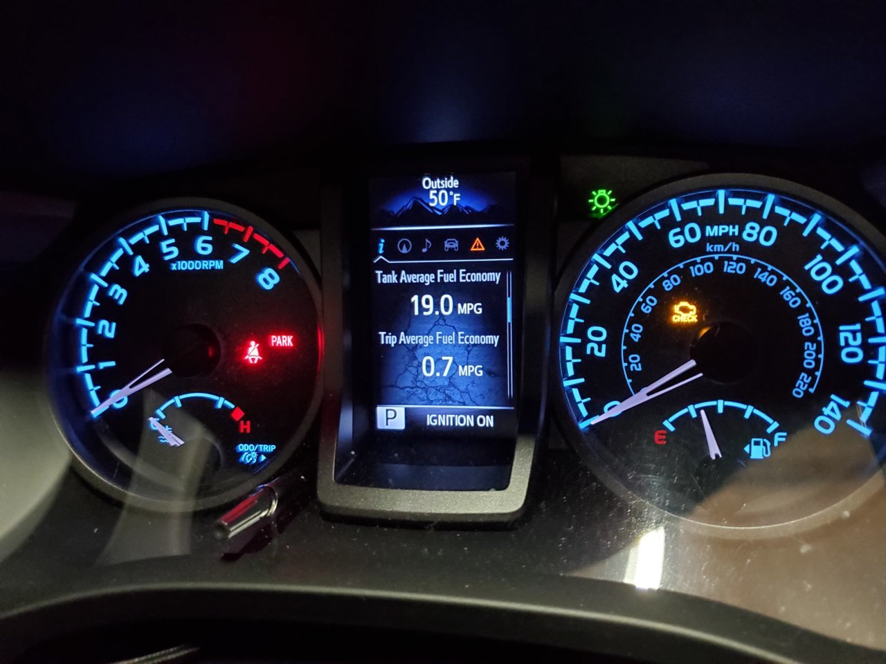

    I just got back from a 275 mile round trip drive over two mountain passes (Snoqualmie and Blewett) loaded with gear and four people. 4-hi was used for about 45 min to an hour coming home last night (otherwise chains were required) and we idled for about 30 minuted to defrost the truck while loading up to come home and another 30 minutes in the McDonald's drive through line.
    I used the ECT button for the steeper climbs, but other than that it was off. The truck drove really nice and I don't usually get this good of mileage on family trips with a fully loaded truck.
    I'm still quite pleased with this update.
