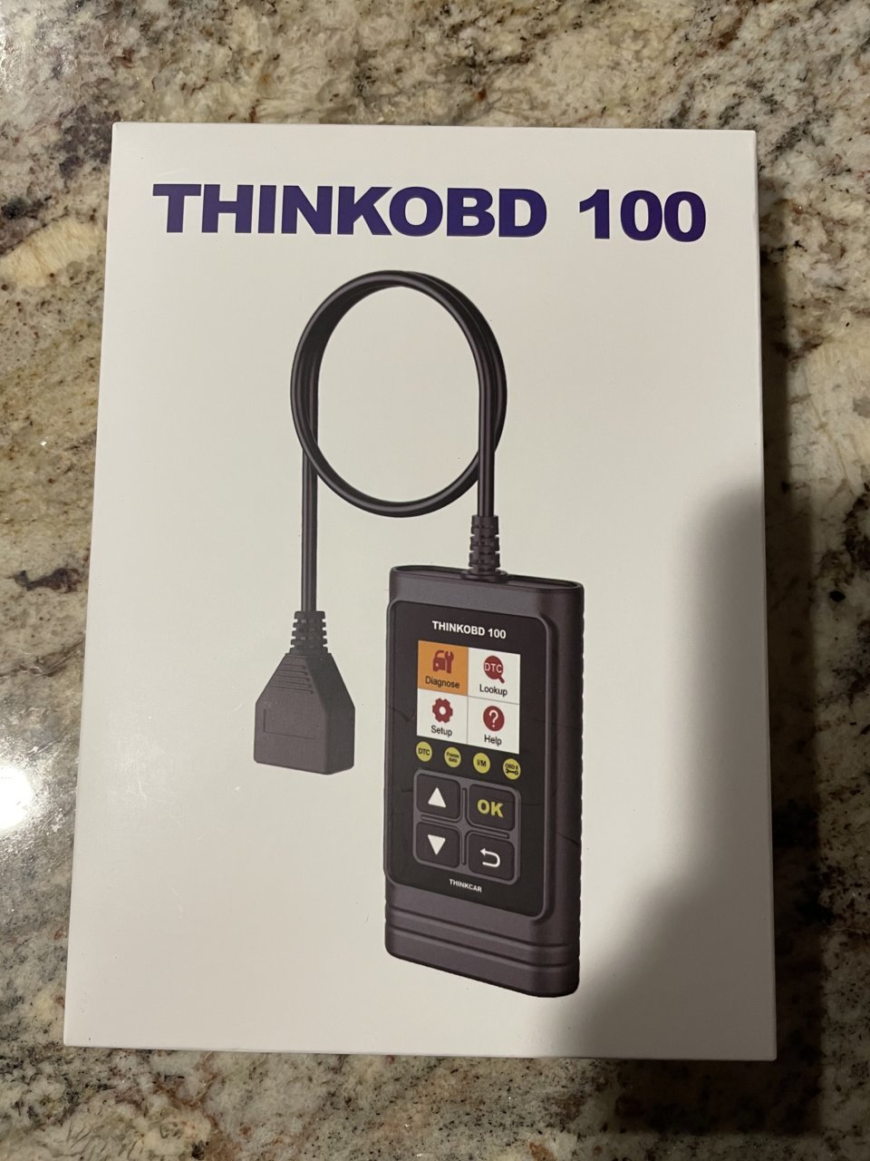

  8. Jan 28, 2021 at 9:20 PM
    #588
    Jim1946
    Jim1946 2020 TRD Sport 4X4
    Sep 2, 2016
    #196234
    722
    San Francisco Bay Area
    2020 TRD Sport 4X4
    I bought this one recommended by Scotty Kilmer on YouTube. Only $35 on Amazon. Does everything the average DIY mechanics needs. 419268A3-0083-4BD8-A787-7107180294B0.jpg
    horntac1[QUOTED] likes this.
