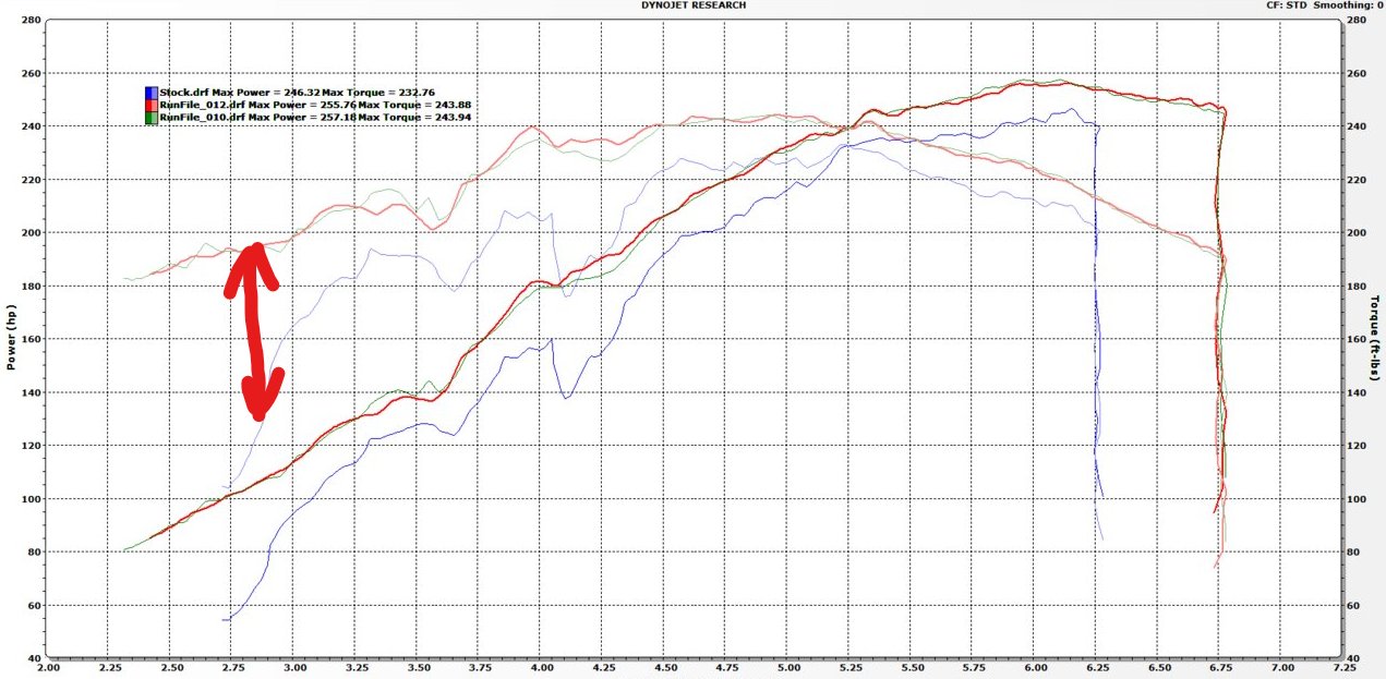

    Combine this with OVTune and it’s even better!
    Also some dealers charge, the good ones don’t.

    Personal opinion: I have not used OV Tune. Before I got this, I was considering getting OVT, there's a guy local that does it for...200? 300? Can't remember, might have been less, was definitely considering it.
    After this - not a chance, I like it enough that I have zero desire to spend more money, it drives spot on in my opinion. I didn't dislike the old tune though, I just had the gear hunting. I also didn't come from a WRX like a lot of people do, and am not expecting it to drive like a high performance car :p

    I understand where you're coming from here, but it is still this difference that is not addressed on the latest TSB:
    The smoothed power delivery is also a big deal to me. The revised rev limit doesn't hurt either. LoL!

    SOS bolt-on sliders In-cab sleeping platform J-Dub IFS Skid
    Emphasis mine. If that's worth it to you - hell yeah, do it. Just like heated seats are not worth it to me (even in the northeast). Others, it's a must have. No big deal. Just my 0.02$

    Agreed. That is why I like to emphasize my opinions also.
    I just wanted to point that out. I spent two tanks on the latest TSB tune that is similar to your 04B81 and had my fill of it. It did provide a great base for the tune.

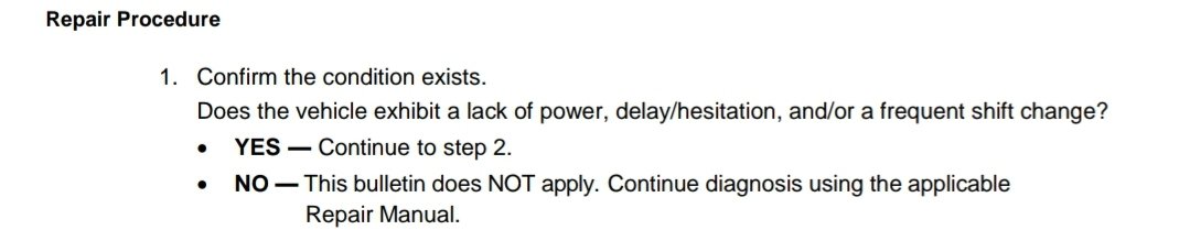

    So went to my stealership today for service and they asked if there was anything else. I described the symptoms as I feel in the vehicle. I told him I found similar issues online via the NHSTA and complaint sites and found TSB-0092-20. Service was completed, I come back and he said “the ECU was not updated because the technician couldn’t replicate the issue (in what appears to be <10 mile drive)”. I didn’t argue just said that I would deal with corporate...he said “hey don’t get mad at me, I am just the middle man”. ToyoCare complaint filed.

    that is the issue with THAT AND OTHER DEALERS... the TSB clearly states, does not have to be replicated by dealer staff. they deserve a poor survey, and yes, that service advisor does too. if his, and the dealerships bonuses (pay) are linked to the surveys, they should do anything and everything, to make sure you are satisfied. pulling the "not my fault card" is not an excuse. good luck on getting yours sorted, it is worth it. Ski

    Step 1 is to confirm the condition exists. While the owner stating the condition exists should be enough, this is where they are saying "could not replicate."
    I'm actually somewhat glad the dealer service people are assholes, because that pushed me to get Techstream and now I will need them even less.
