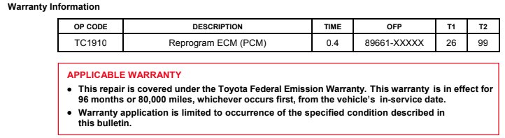

    Should be able to notice. If they put it on your paperwork they probably did it. Pretty sure any obd 2 scanner will do it. Just the cal id. It should have slightly higher shift point or not rapid fire to the highest gear. It feels like ect light.

    I went in today and had them do my TSB (I think?), navigation update, and turn signal clicker from 3 to 5.
    They definitely did something to the computer. Receipt says PERFORMED REPROGRAM ECM T1: 26 | T2: 99, and it is incredibly more responsive. But I don't know if that's the same TSB upgrade.
    They also definitely upgraded my navigation. Tested it out on the way home against my google maps on my phone and it wasn't making aggressively stupid decisions.
    For the turn signal clicker, they claimed they couldn't do it (in person), or there was no option available (receipt). This is on a 2019 TRD Off Road DCLB 4WD.
