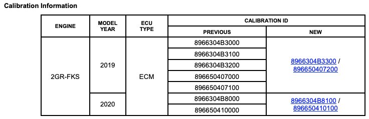

    I had the TSB done last week, and noticed a big difference in holding the gear up to about 40 mph. On the highway (>65mph), it still down shifts (to lower gear) when I hit the SLIGHTEST of inclines...same as did before the update. Guess I'll just have to live with that.
    1 - So once the TSB is done...does the transmission "learning and adjusting to the driving habits of the driver" feature, start over...? 2 - I have a OBD2 reader for fault codes, etc. Can I read use it read the current ECU Calibration...to confirm it is 04B33.

    Learning is always active. It is a big deal if the folks doing the flash Reset the DTCs and Learned Values. But, it will adapt over a decent amount of time.

    Can someone tell me where the ECU calibration ID can be found in the OBD Fusion app? I tried to check mine bout didn’t see ECU ID anywhere. Thanks

    Not familiar with that app but, on my obd scanner it’s CID.

    @Cwopinger --- I believe if you go to 'General Information', they would be the Calibration IDs "ECU 7E0" and "ECU 7E1". Depending on the year of your truck, match it to the new IDs below:
    Hope this helps.
