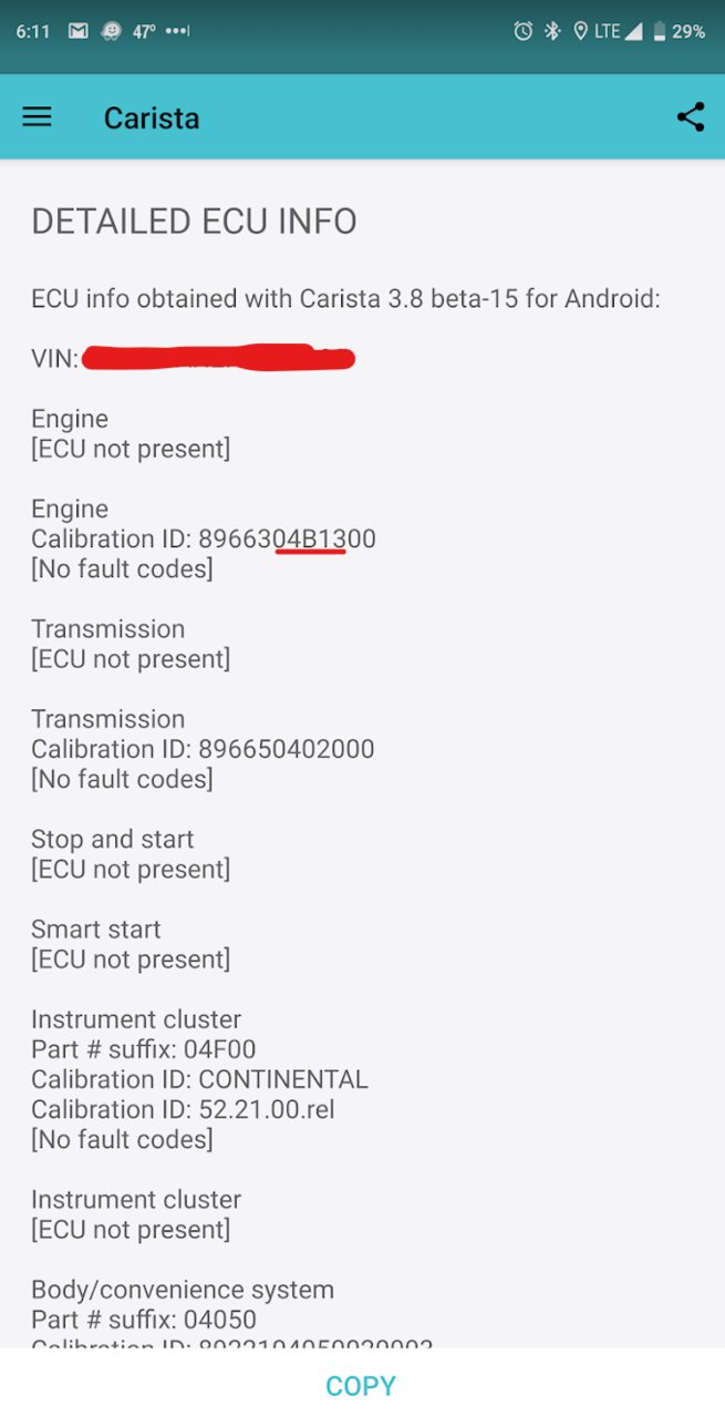

    Great - thanks - I assume there is a quick way to tell? I've not dealt with anything on the ECU up top this point

    Or with TechStream and a Tactrix adapter.
