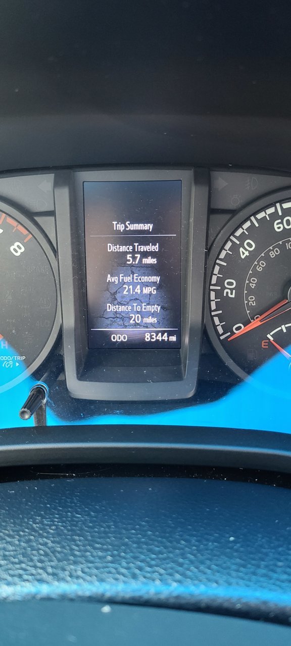

  4. Mar 10, 2021 at 9:59 PM
    #784
    Tmaloy
    Tmaloy Well-Known Member
    Oct 3, 2019
    #306953
    344
    Troy
    2019 SR DC LB
    Truck never got this MPG before. 3rd time I got this off the dash display since the TSB.

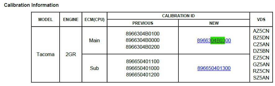

    That is actually an obsolete TSB. I believe it notes ECU ID 04B03. Attached.
    You should check to see if you are updated to 04B04. The OBD Fusion and Carista apps, some handheld OBD readers, and TechStream will tell you.
    As noted above, I expect another TSB to update folks beyond 04B04.

  16. Mar 11, 2021 at 8:40 AM
    #796
    foxtrapper
    foxtrapper Well-Known Member
    Oct 19, 2009
    #24536
    148
    Thank you tonered. So there’s another update(flash) that is different than the one I had done?
    tonered likes this.
