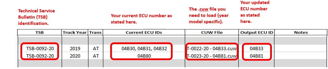

    So if we don't have the a OBD Fusion or any other tester is the 407200 the same as the tsb-0092-20. Or is there different versions of the tsb-0092-20. My paperwork from dealership only says the tsb number

    All one in the same. The 92-20 is the bulletin identification number stating the issue and the fix (flash). Your reference to 407200 is the result of the flash. You're good.
    Your question about different versions is valid. There is one bulletin that address both the 19 year make and then the 20 year make.
