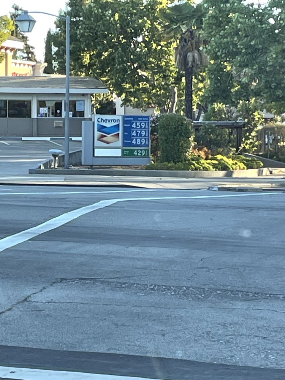

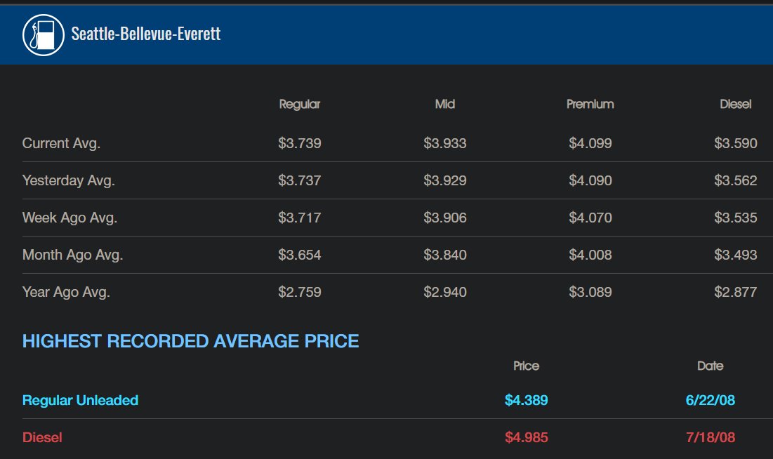

    Yikes. That beats our record cost by a lot:
