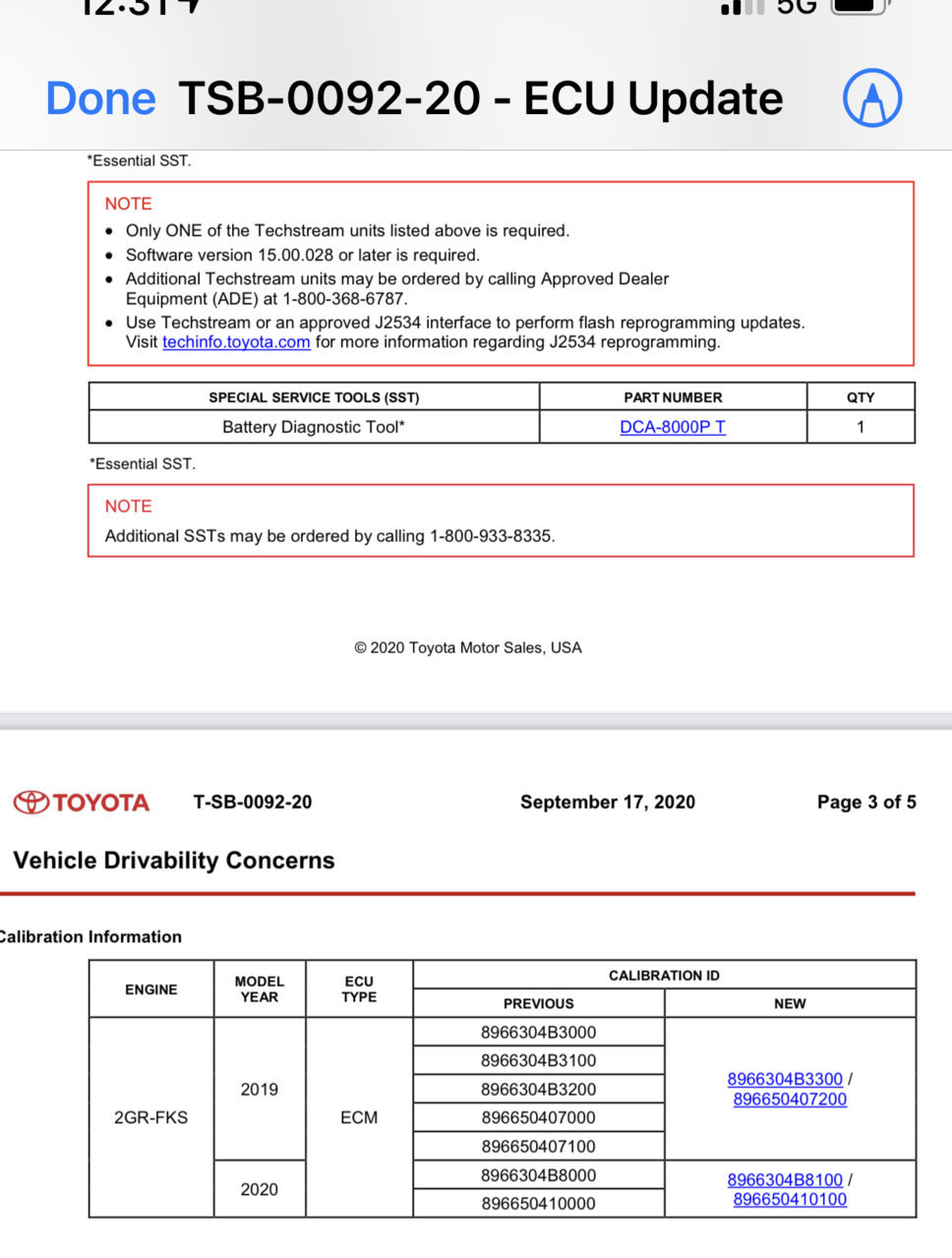

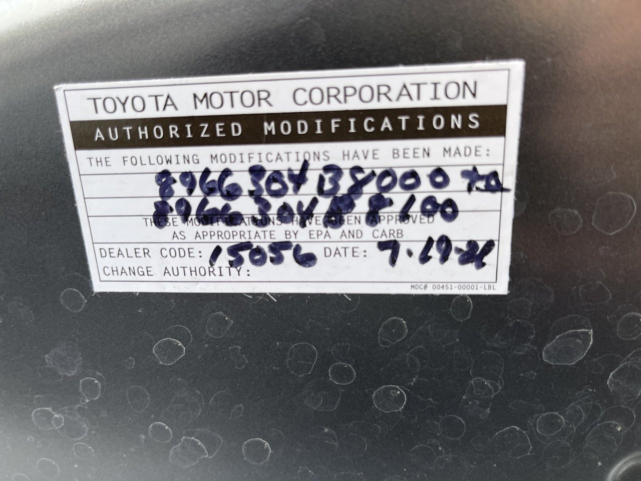

    I had my dealer do TSB 0092-20 today on my 2020 TRD Pro
    No problems asking for it and getting it done, but I did provide a copy of the TSB.
    Here is the new sticker that was placed under the hood.

    This looks correct according to TSB for my 2020
