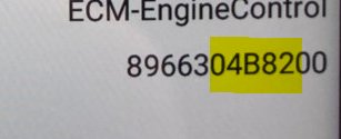

    You're actually 04B82 in your second pic, which is the latest. The problem is that the right side of your first pic was truncated a bit. Maybe by zoom or scroll on your phone. You are right that it was 04B80 though.
    Also, posting your VIN isn't good. Some bad folks can use it in bad ways.

    Thanks so much @tonered - so just to confirm, if I went from 8966304B80 to 8966304B8200, this provides the same benefits as the 4B810 update listed in the T-SB-0092-20? I notice running a search thr 4B8200 relates to a seperate service bill item T-SB-0045-21 relating to crawl control but if it covers the same as 4B810 + some that’s fine by me

    Yes. You were actually 8966304B8000. It was just cut off on your screen. 04B82 captures 04B81 plus the CC fix, like you guessed.
    You should notice some of the stuff that the 2019 folks with 04B33 are talking about. A bit more power, control, and settled down shifting.
