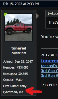

    Oh sweet! I noticed your location but just thought your be able to steer me in the right direction. Of which I suppose you also did.
    I'll dm you to see if we can meet up.
