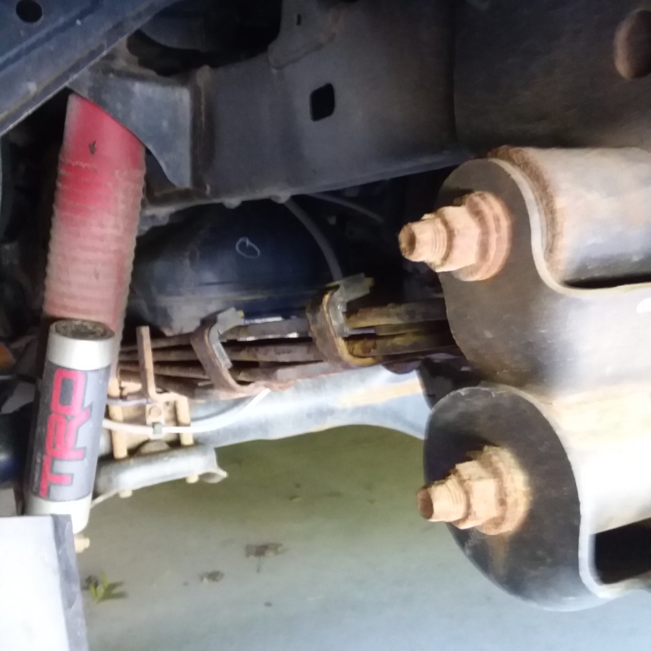

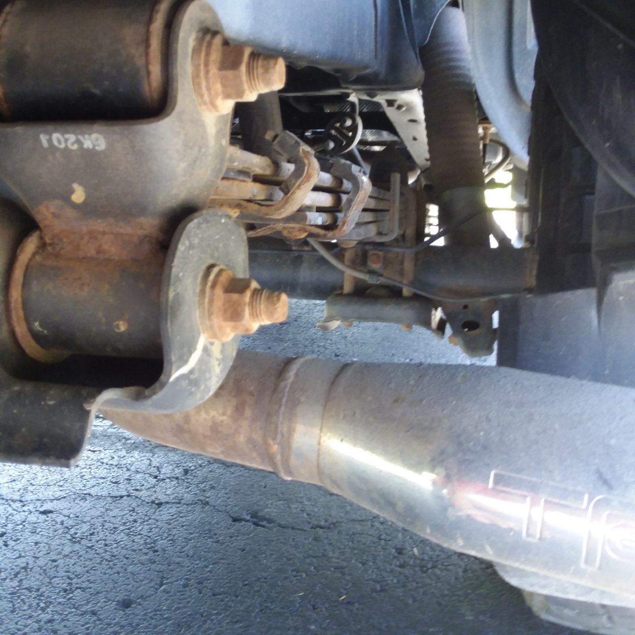

    covered under 60,000 power train warrenty.. just had mine done monday,, squeaks gone , but i had to fix the c-brackets when i got home.. really bad tech, never closed the brackets after service right side3.jpg left side after service (2).jpg
